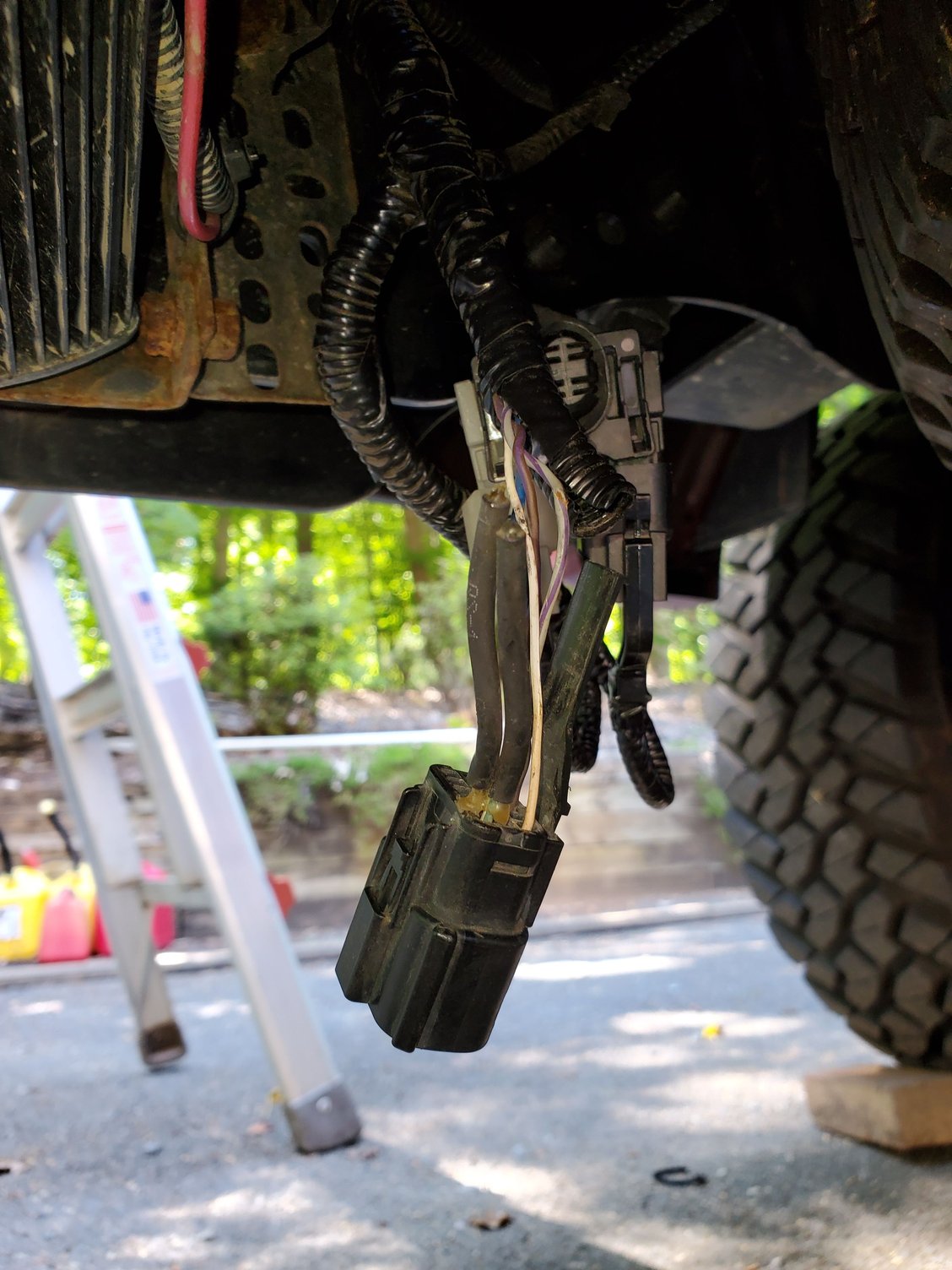

Originally Posted by Kdawg89
Hi All,
I keep hearing about this connector somewhere near the spare tire that has been causing electrical issues for a bunch of people. I am thinking of checking it out on my truck, does anyone have a better description of where the connector is located?
Thanks!
I presume you are talking about the one causing the tailgate to come down. Here is a pic after the recall. My dealer's mechanic folded the pigtail back on itself causing it to rub through on the factory wireloom. I put hot melt glue on the exposed wire. Its getting redone this coming week. Its to the rear on the driver's side of the spare. On the frame rail.
