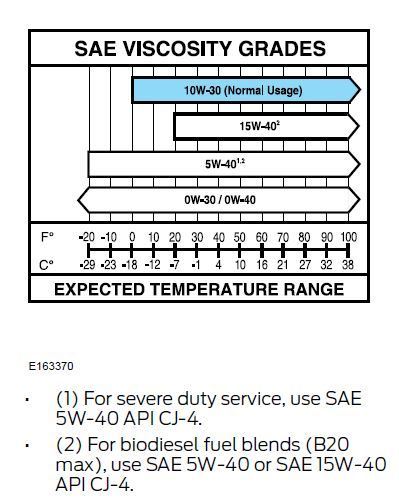

Likes: 91
Originally Posted by ford390gashog
The 5w40 is required for severe duty use, 15w40 is not approved for severe duty service.
Red print below for correct info.

That's the first document I've seen that lists anything other than 5w40 for severe duty use. The diesel supplement manual that came with my truck only lists 5w40. Even the oil cap indicates 5w40 for severe duty.
What is the source of your info?

I suppose it depends on which part of the manual you look at. One section said 5w-40 or 15w-40. This section, from version 3 of the Owner's Manual on page 330 mentions only one viscosity:
Engine lubrication for severe service operation
The following conditions define severe
operation for which engine operation with
SAE 5W-40 API CJ-4 is recommended. Oil
and oil filter change intervals will be
determined by the Intelligent Oil Life
Monitor™ as noted previously.
• Frequent or extended idling (over 10
minutes per hour of normal driving).
• Low-speed operation/stationary use.
• If vehicle is operated in sustained
ambient temperatures below -9°F
(-23°C) or above 100°F (38°C).
• Frequent low-speed operation,
consistent heavy traffic less than
25 mph (40 km/h).
• Operating in severe dust conditions.
• Operating the vehicle off road.
• Towing a trailer over 1,000 mi
(1,600 km).
• Sustained, high-speed driving at Gross
Vehicle Weight Rating (maximum
loaded weight for vehicle operation).
• Use of fuels with sulfur content other
than ultra-low sulfur diesel (ULSD).
• Use of high-sulfur diesel fuel.
Every section that mentions Biodiesel B20 includes the recommendation to use 5w-40 or 15w-40.
Old Jan 6, 2019 | 12:06 PM
  #29
Just Strokin's Avatar
Just Strokin
Joined: Nov 2001
Posts: 6,748
Likes: 118
From: Tallassee, ALabama
Yes, every section that specifies biodiesel over 6% to 20% does say use 15w-40 or 5w-40 but it does not identify using 15w-40 for severe duty. The manual only specifies 5w-40 for severe duty.
