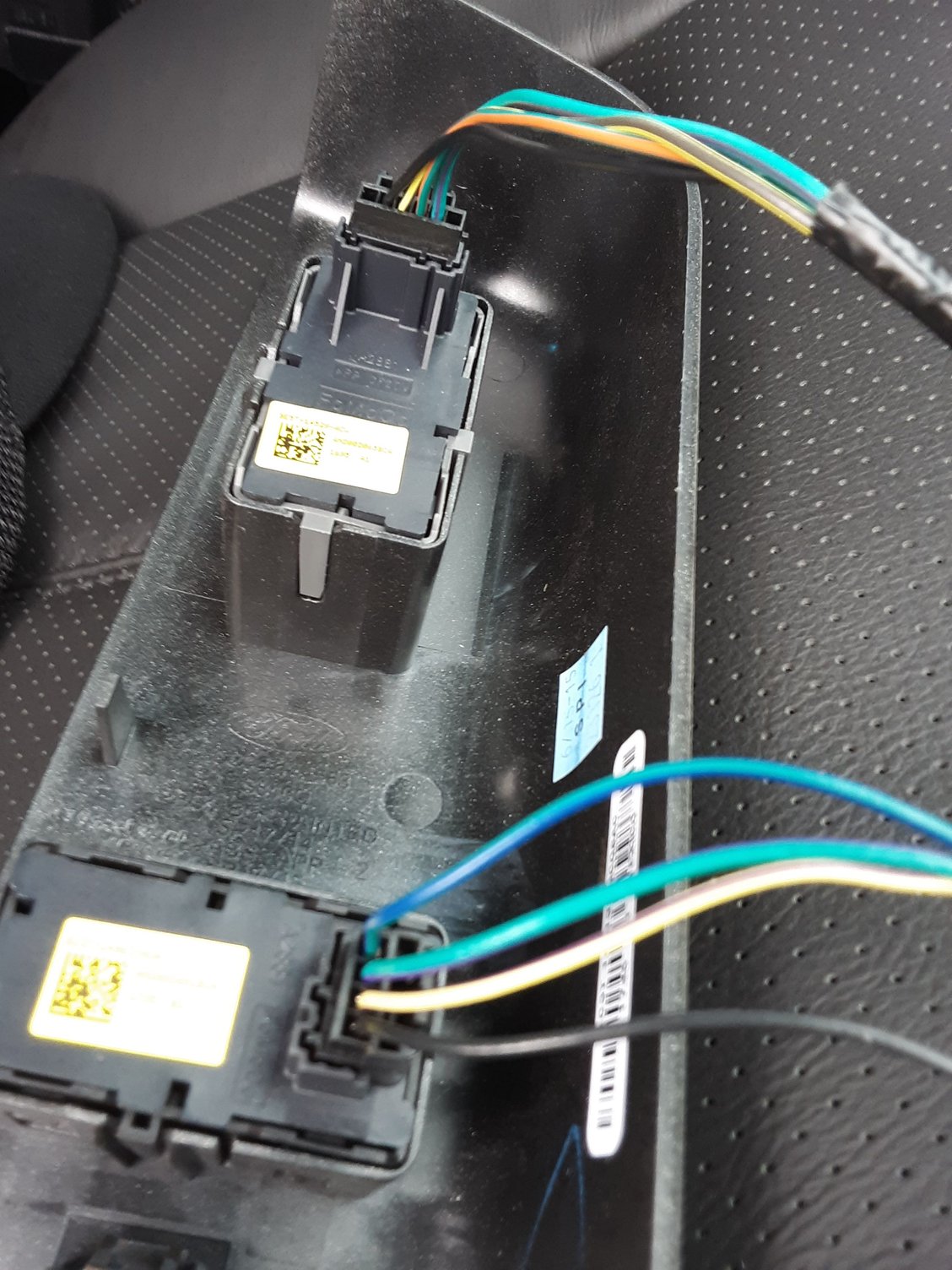

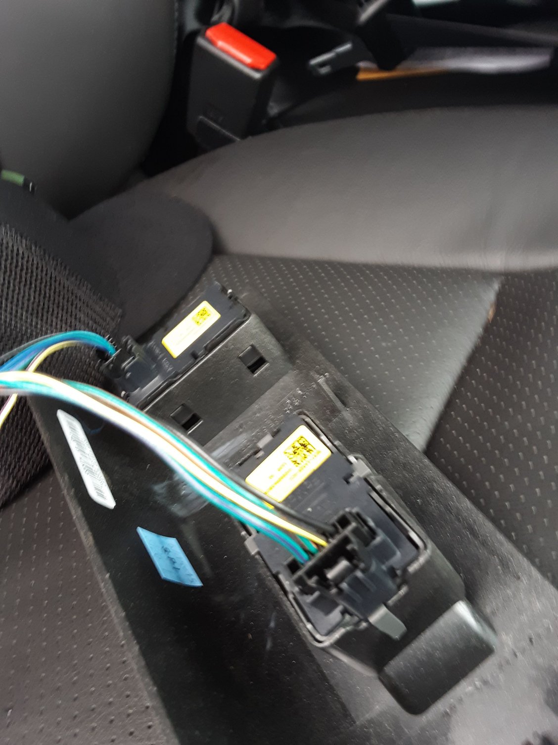

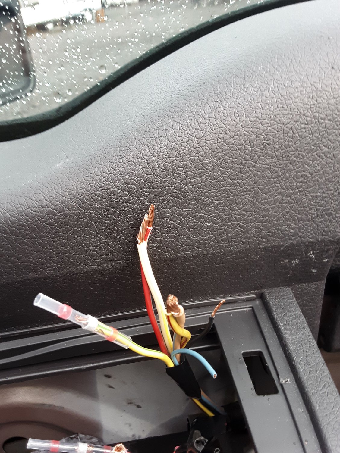

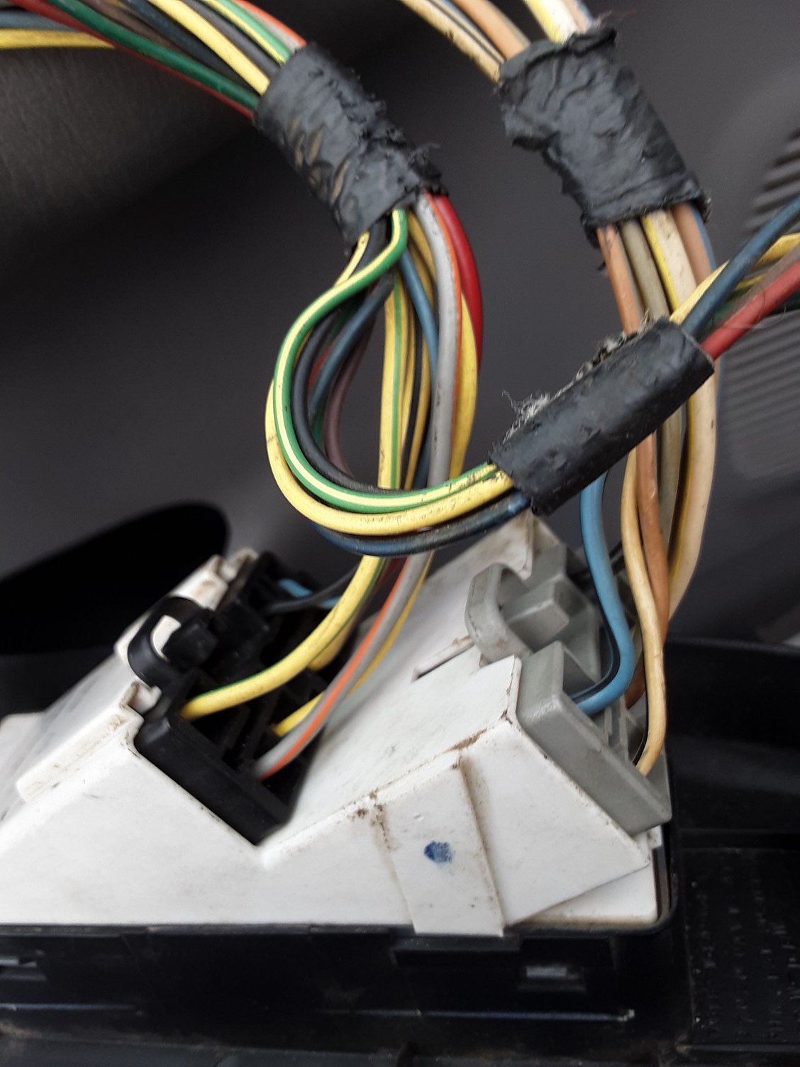

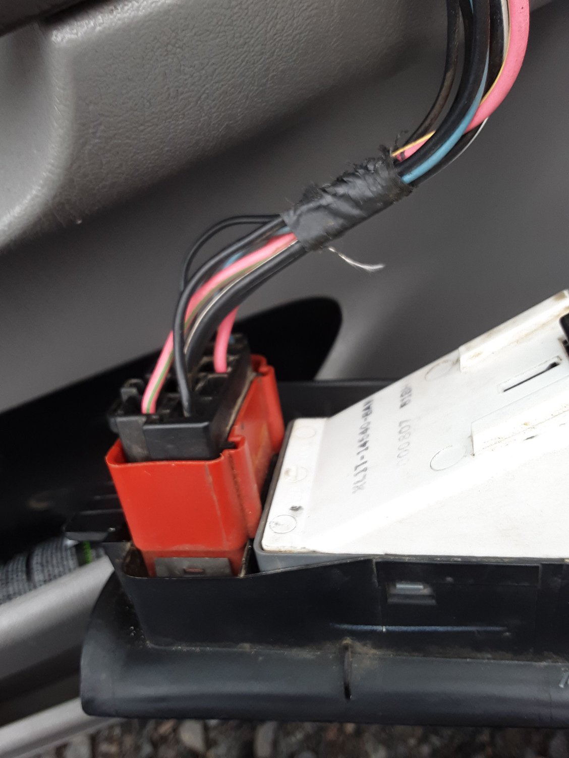

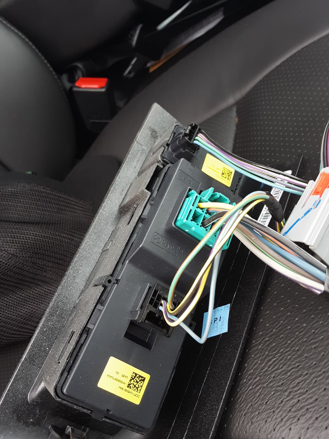

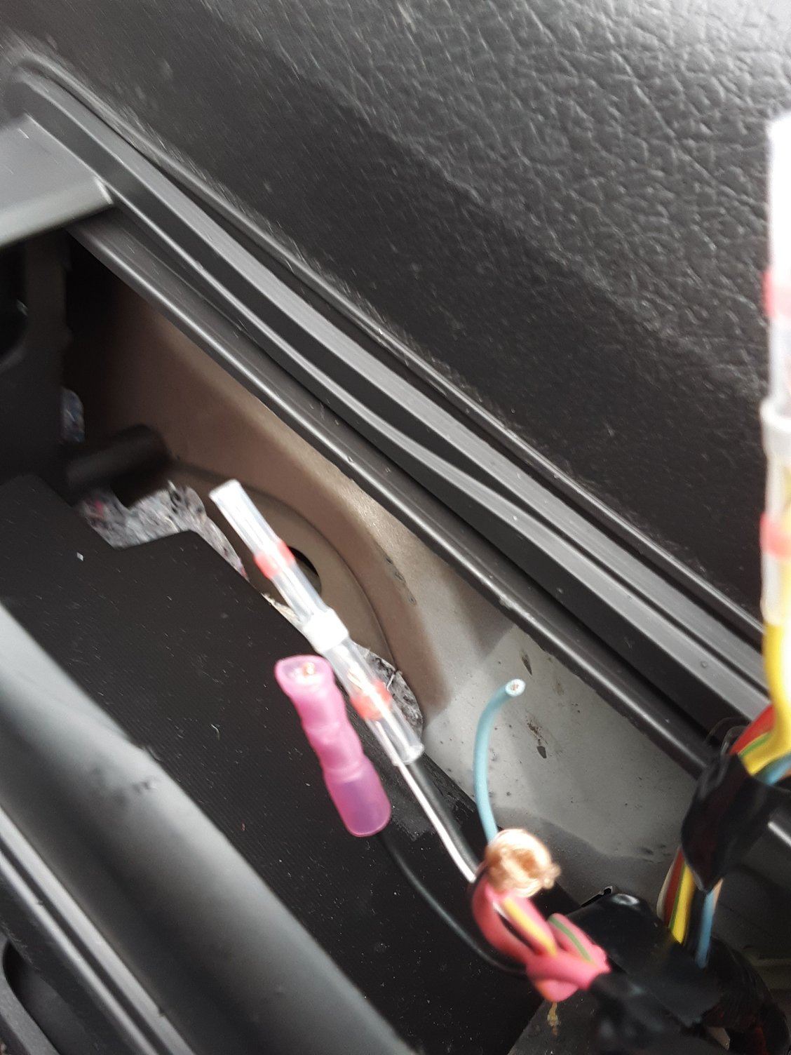

After review, and taking to the rest of the work crew, we have been able to write the rear windows and they work just fine. Ar far as the other two were have looked at the wires and found that the old modules have 5 wires and the new modules have 4 wires. See attached files.
Old driver side
Old driver side
Old driver side
Old driver side
Old pax side
Old pax side
New
New
New
