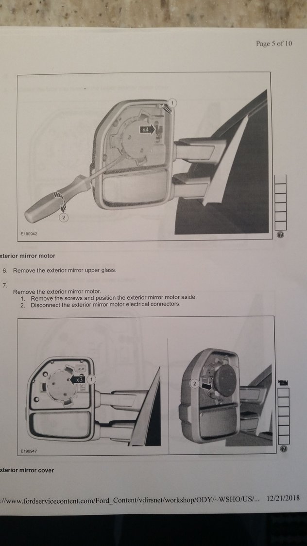

No Phillips head, bolts.....good news is my dealer will pop off the glass for me at n/c. They also gave me a printout that shows a spot roughly at 7:00 on the drivers side, or 4:00 on the passenger side that a screwdriver would slip into to pop it off.....still not confident i won't bust a tab....so might just let them do that part....rest is easy from the looks.

Regarding the spits to pop it off, you’re saying that these mirrors have one spot, not the eight that the F150 in the video have? That is good news...please keep us posted Thanks.

Part came in, went to dealer and the shop manager pulled truck in and he just popped them off (mirror glass).
the metal tabs I saw are just anti vibration. Will do pics later when it stops raining.
