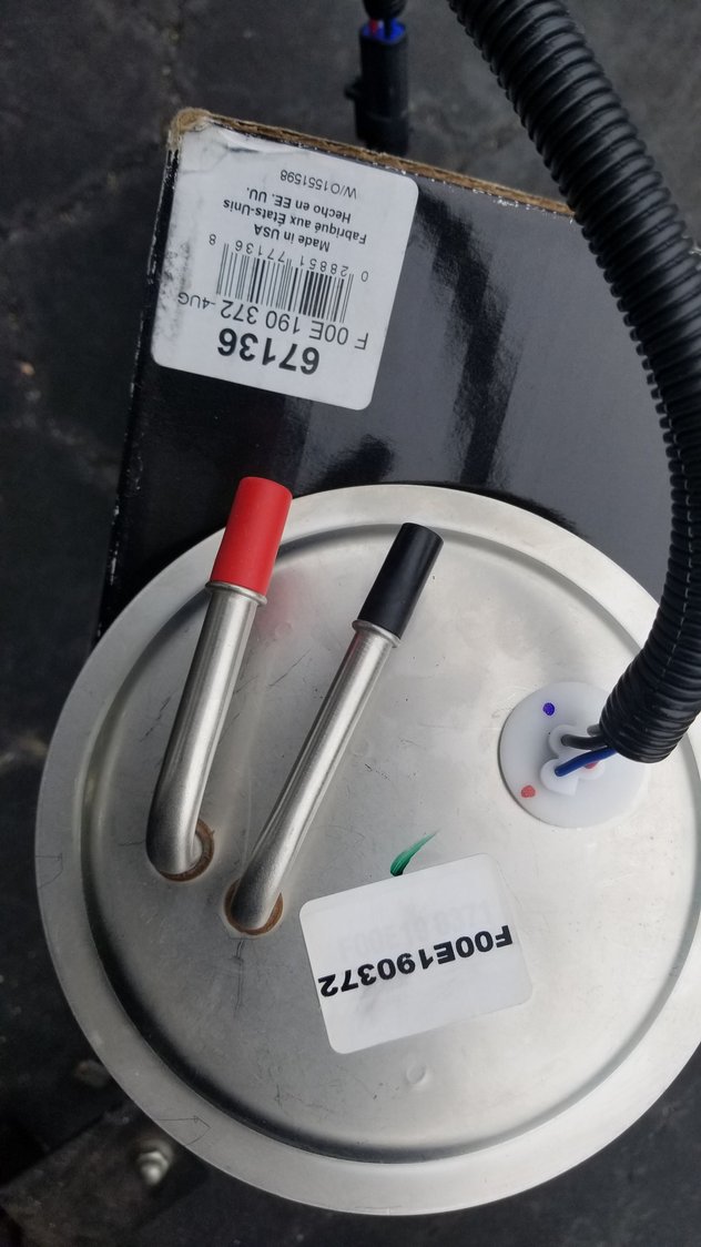

2004 V10 RWD. Seems mine has a California fuel pump version. I had purchased a BOSH pump 1st and it is missing a sensor at the top of the pump cap. Had to order a 2nd one that is for CA emissions. The float rod can be bent to adjust the gauge range.
CA Emissions Version
CA Emissions version
Standard (non CA) version
Pump parts and sender are non-interchangeable. Note elbows on each sender rod. This bend can be increased or decreased to adjust gauge reading.
44 gallon tank

In my photo with the 2 pumps, note the clips on each pump. There is a cup in the bottom of the tank, the clips snap onto the upper lip of the cup to position the pump in the bottom of the tank.
All this may differ for yours as mine is a 2004 V10.
