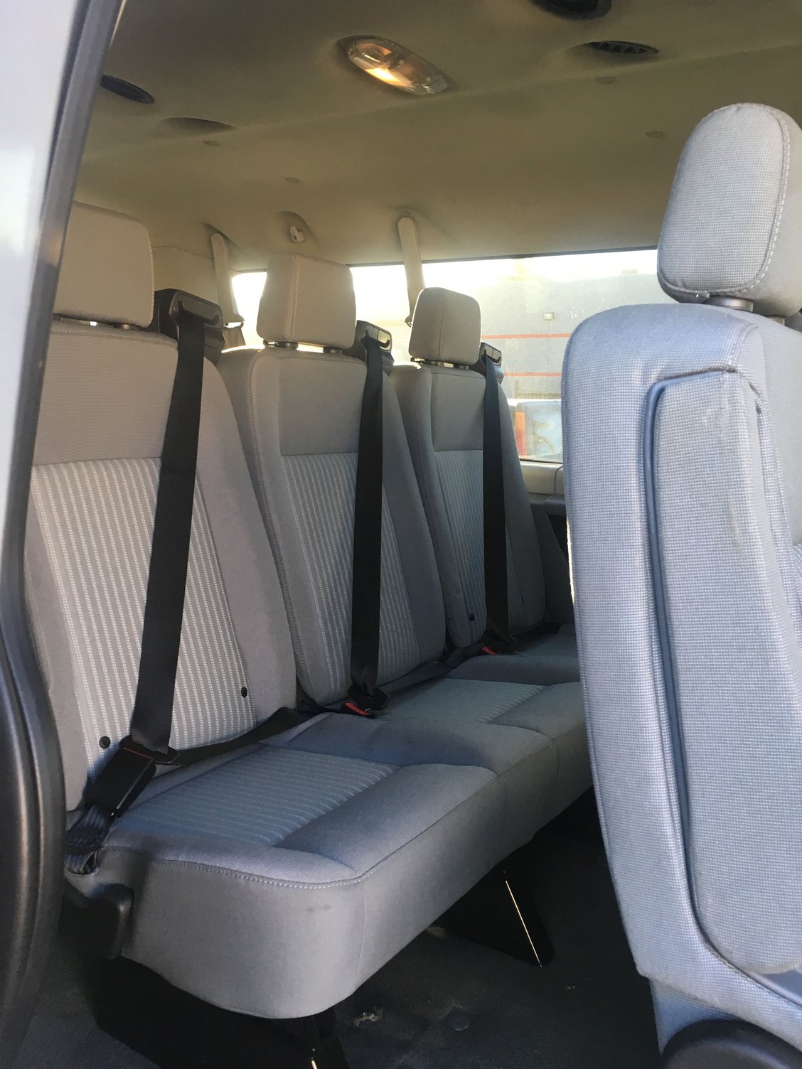

Originally I was speaking of the rear seating for my plentiful passengers - 8 kidos at the moment
Anyway I ended up replacing our lost 2002 E350 with a 2004 E350 with super low miles in my mind.
While I was in CA picking up the vehicle I got cvcandmore [1] to put in transit 3 seat benches.
It was a quick install and they went a bit over closing to help me out.
So far the family likes them not much seat time yet though.

I'm very interested in what you did here. I actually just picked up three rows of three Transit seats to put in my EB E350 soon. I've been kicking around different ways to actually mount them, and I was curious how CVC mounted yours? I can't tell from the pictures, but it looks like they're fairly flush-mounted to the floor. There are hooks for the factory brackets that it looks like they removed. Do you know how they bolted them to the floor?
*Actually, on closer look…they don't look like Transit legs at all. Any input would be most helpful…

@Sigg Huge apologies I meant to write back months ago...
So what CVC did was just drill the floor and drop two bolts through each "leg". On the underside there is a larger, flat steel plate for each bolt as well as a lock washer and the nut (32lbs torque).
Pretty simple but it works. I've taken two of them out so I could get at the side panels and remove the overhead seatbelts so they are semi removable.
Ideally they would be on track or clip systems like the original seats but I could not wait nor had the $$ to figure that out with a fabricator of some sort.
Anyway.. Hope that helps a bit.

No worries, man. I'm slowly in the process of getting my L-track mounted and my plywood floor in. The L-track will be mounted in such a way as to work with the spacing on the legs of the Transit seats. Pretty stoked to get it all in and together. Just haven't had a lot of time lately…
