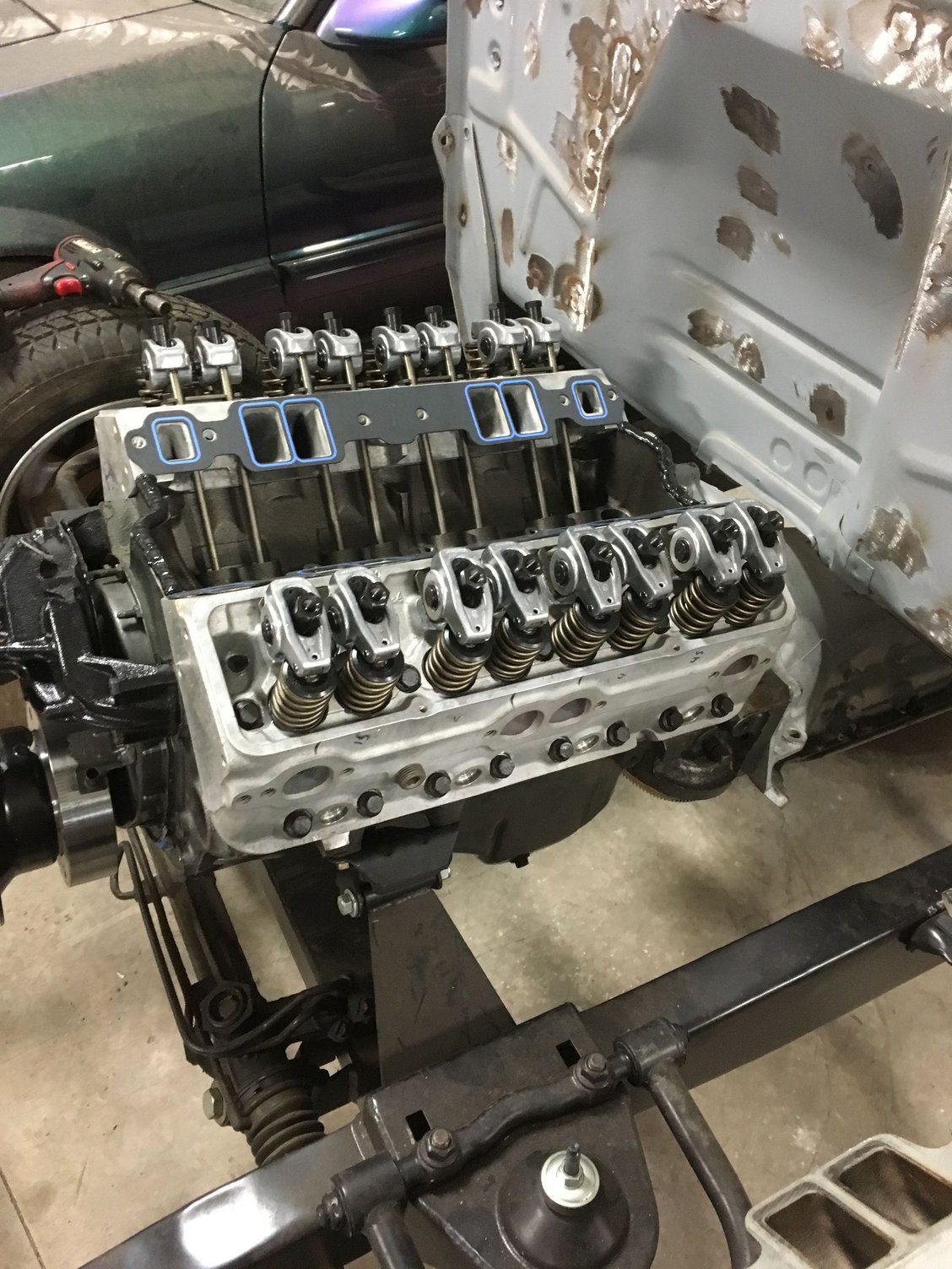

I have a 51 F1 with a mustang 2 IFS frontend and a small block chevy and I am struggling with header fitment. I have the rack installed and the motor, I don't have the steering column installed tho (nor sourced or bought). I tried full length tubes and they wouldn't even fit in between the frame rails without modifications and then the collector is right where the shaft would have to come up. block hugger headers put the collector right behind the spline hub off the rack.....

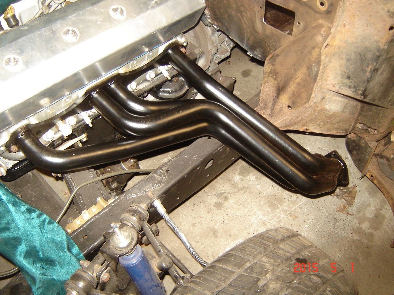

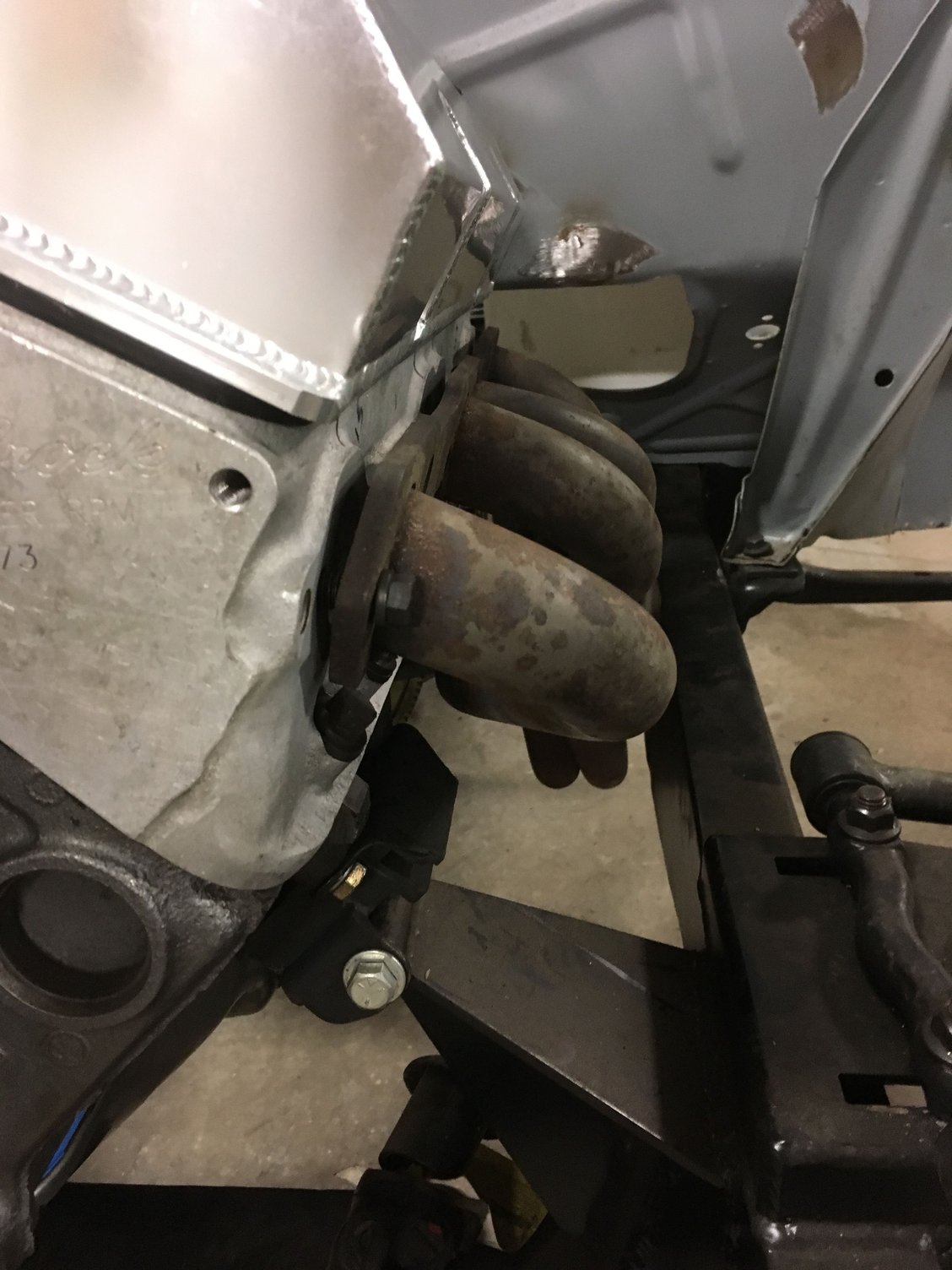

here is the long tube set- they dornt seat against the motor because the are pinched on the frame rail. the collector also is an issue but I was thinking about cutting the flange and shorthning the tubes but I don't think the steering will still clear
the flange isnt against the motor

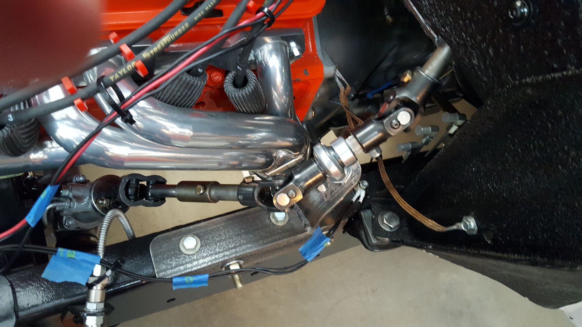

used some steering knuckles to work around steering linkage
from the driver top side
plenty of room between frame,linkage and headers
L8R ZFLASH

From: Lincoln CA
I used Sanderson headers (shorty for early Chev C-10) and ujoints for the steering shaft to connect to my Jag IFS.
Worked for me.
Hope this helps.
