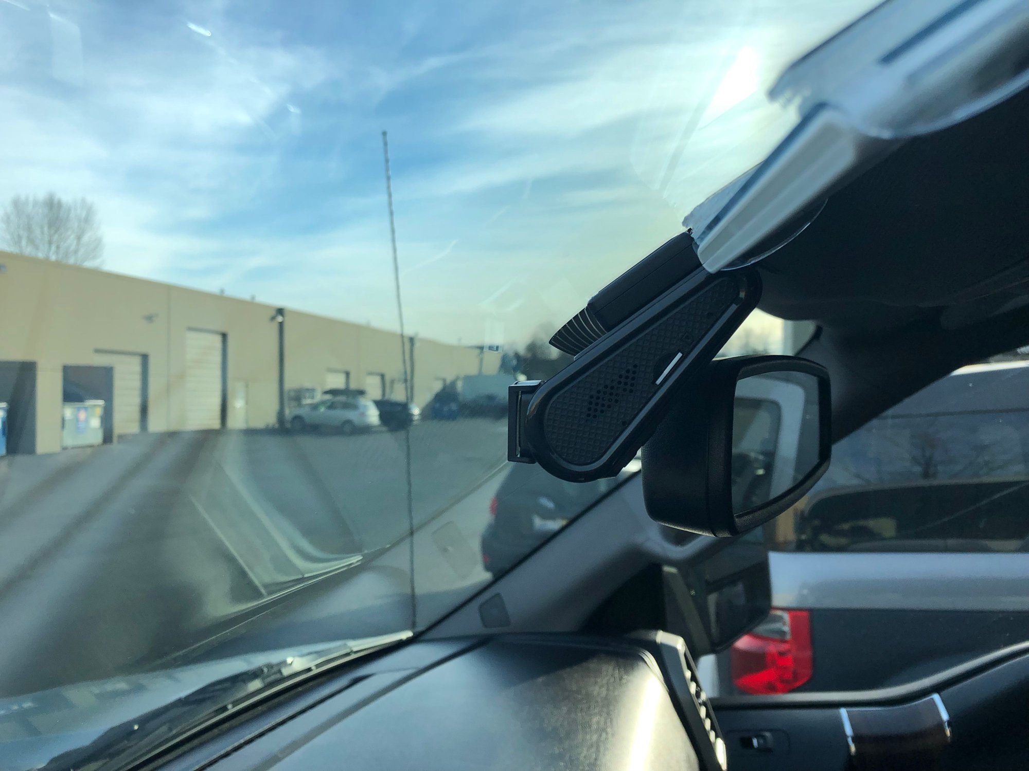

I mounted my dashcam directly to the shroud behind the mirror (It's easy to remove and probably cheap to replace if I want). I drilled a hold and disassembled the dashcam suction cup mount. See pics.
My wires go into the shroud, up to the headliner, across the headliner, down the A-pillar, and terminate behind the passenger side kick panel.
Behind the passenger side kick panel are quite a few fuses. I picked one that is ignition controlled and installed an add-a-circuit fuse.
Now, my dashcam turns on and off with the truck (the dashcam has an always on function, but I have it disabled).
Some people pull their DC power from the overhead console...if I installed one today, that is probably what I would do. I don't have any exposed wiring, except from the dashcamera to inside that shroud.
Also, my dashcam is a Cobra CDR895d. It's been great. However, it is a couple of years old now and I'm sure there are better/newer units available today.

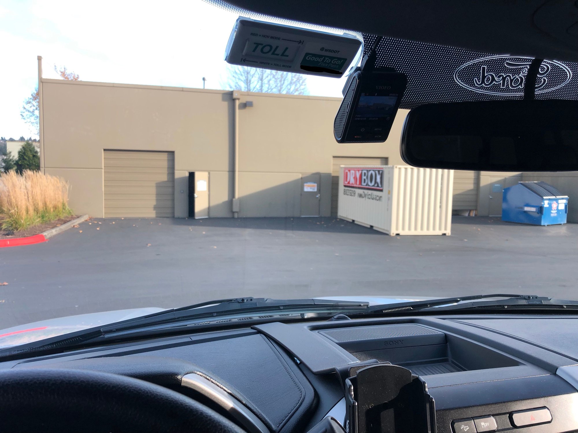

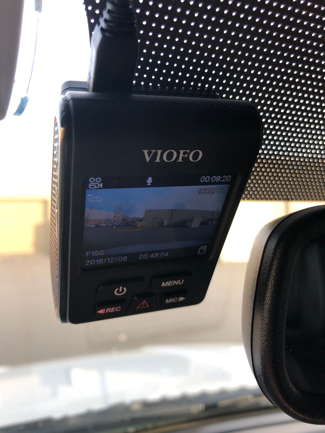

I added the Viofo A119 V2 with GPS a few months ago. There are a couple of good dash camera review channels on YouTube and this was generally the best for the price (from Amazon). It’s not a 4K camera, but I didn’t want to pay $300-400 just for the unit. I watched a bunch of videos and it seems like all the cameras (from any mfg and at any price point) are still pretty susceptible to the elements (especially heat) and don’t last more than a few years. The older unit/version actually got better reviews, but I decided to with this one so I had the latest hardware and I’m hoping software updates will enhance the features.
Overall I’m pretty happy. For power, I stuffed the wire along the seam to the A-pillar and then ran it down, under the dash (left side) and then pulled it out near the power port. Not the perfect install, but lets me easily remove it when needed and pull power if it ever errors out and starts making noise. The night vision isn’t as good as I’d like, but the GPS works fine even attached behind the black sunscreen crap on the window.
