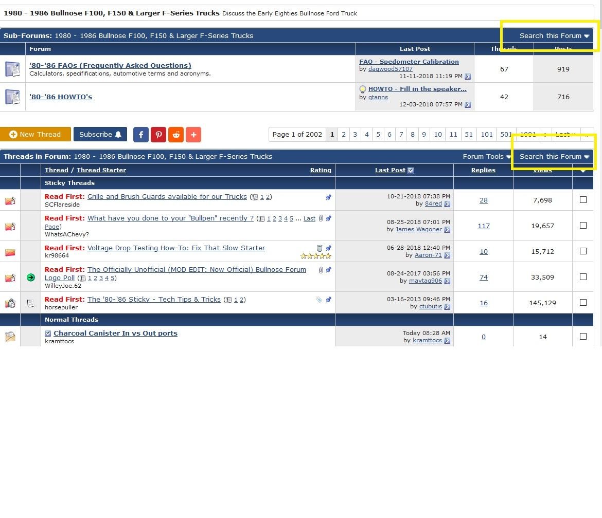

Im new to the forum so sorry if this has already been adressed (if you could point me in the right direction or show me how i can search for stuff just inside of the 80-86 forum that would be great). I am going to buy an 86 f250 4x4 with a c6 and 5.0fi in the next few days and im curious on how easy it would be to convert it to a dually setup and if anyone has any experience and tips on it. Thank you for all your responses in advance.

Originally Posted by ctubutis
Thank you! That makes this a lot easier.
