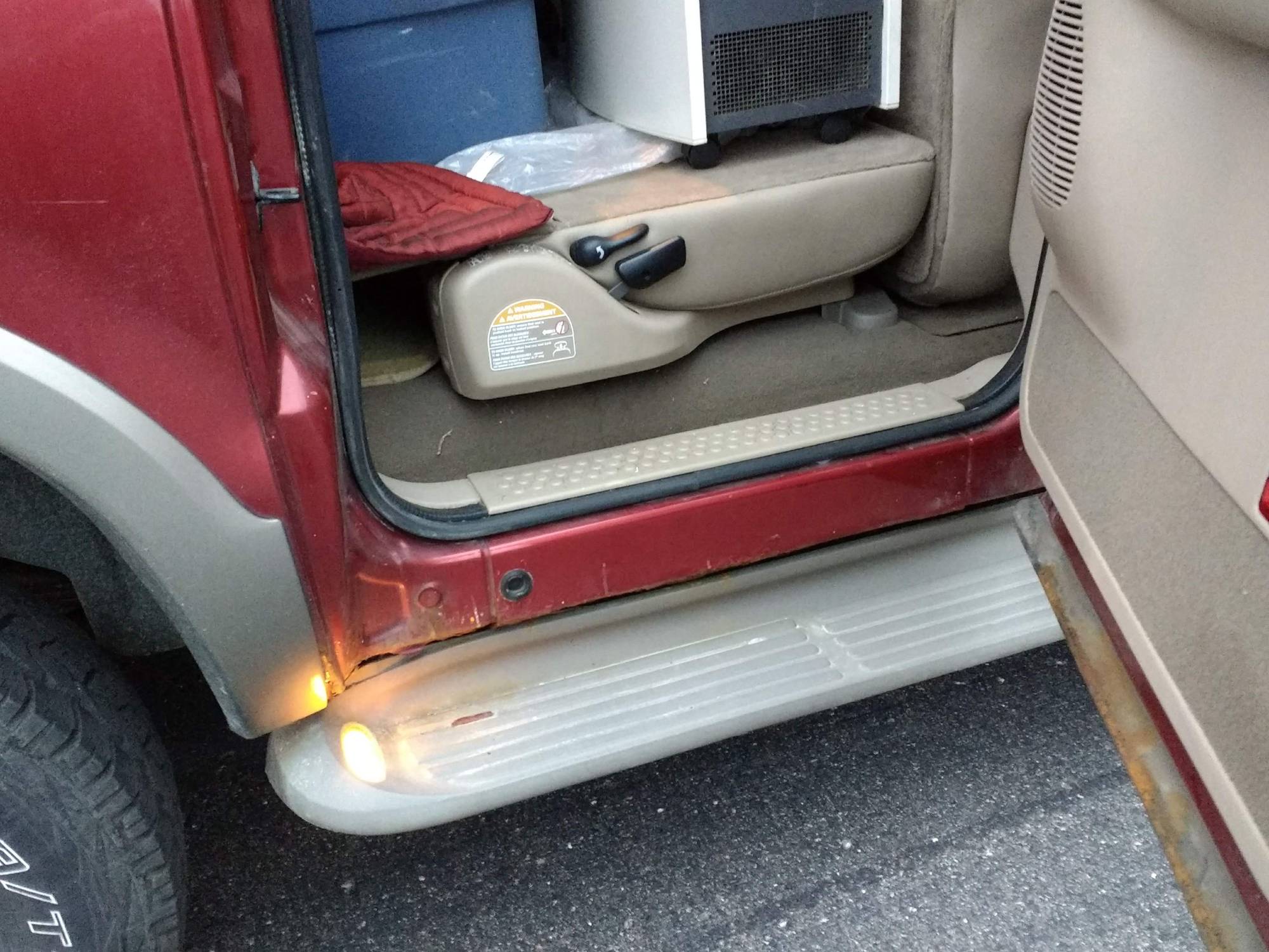

Dad, I don't know your body work skills but for me any serious body rust/rot is a deal breaker for any vehicle purchase. From the pictures and it's MI history that one needs a very close and thorough examination of the under cab floor, inner/outer rockers, rear door frame doglegs, and all door bottoms as these are the most rust prone areas. It is very easy to spend more on serious rust repairs than the initial vehicle cost if it requires extensive restoration work, especially if your skill level (like mine, to an extent) requires the work to be farmed out to a body shop.

My3sons, keep looking. That rust infection is terminal. You will never be able to mitigate that without spending lots of money and LOTS OF TIME.
Is that based on what you can see just from the undercarriage pictures?

If crud then the areas that need closer inspection are the rockers as has been has been pointed out, The rockers themselves are fairly easy to replace, It is the door dog legs that are no longer available. Also the driveshaft and trans crossmember look to be wasted. I would spend an hour under there with a flashlight and look over every single nut, bolt and square inch of the undercarriage including the oil pan ( those are known to rust through and the motor has to come out to replace) As you are inspecting realize you will have to deal with the rust one way or another, Either trying to stop it now or replacing stuff as it fails.

It’s a stupid newbie question I know, but it’s my thread ... What section is the “dogleg”?
Old Dec 4, 2018 | 09:22 PM
my3sonsdad's Avatar
my3sonsdad
Joined: Nov 2018
Posts: 94
Passenger side doors
