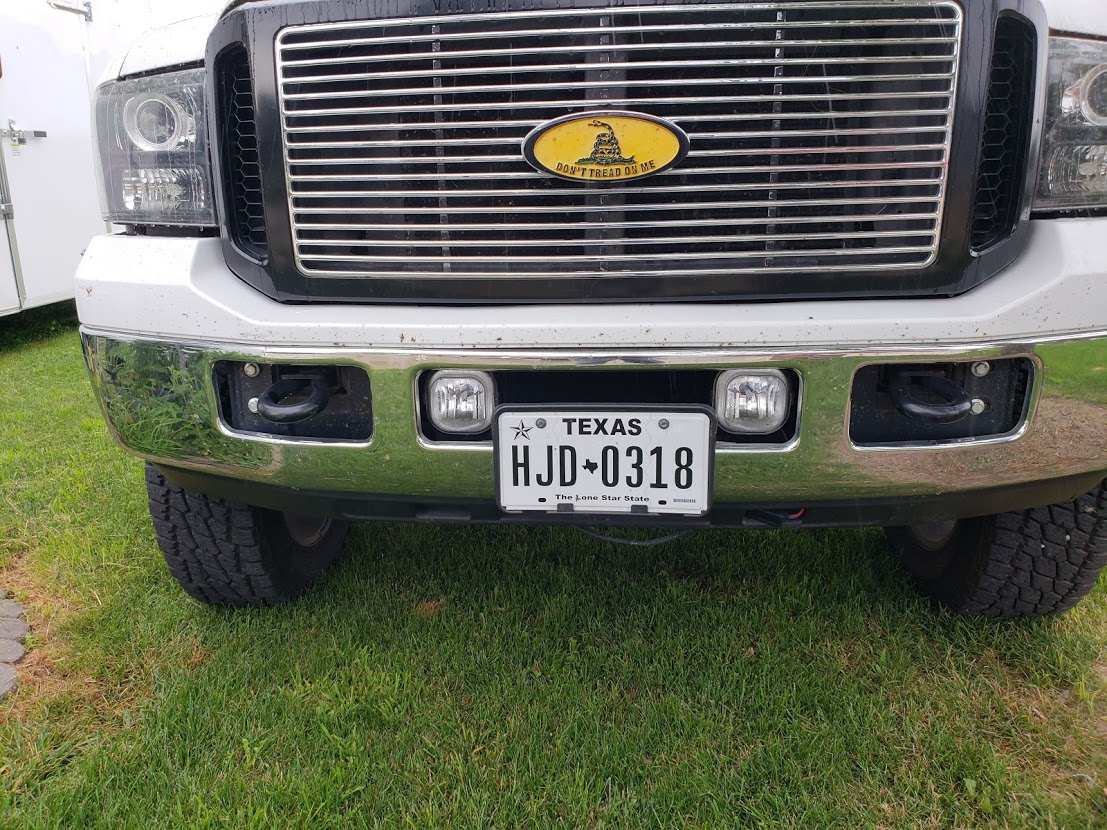

I have a set of the 05 style with the morimoto projectors in them, put together by a member here. I've had them for a couple years now and I'm very happy with them. They have the "high beam" shutter.
Sorry I've never done a halogen comparison between the 04 and 05 headlight styles.

How did you go about finding a member on there to have this work completed? I would eventually like to upgrade and a plug-and-play solution from someone on these boards seems like a decent avenue to pursue.
