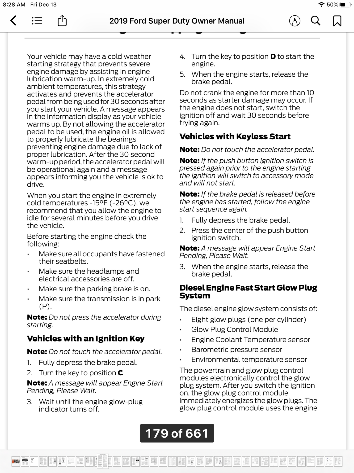

Old Dec 13, 2019 | 07:31 AM
crewzer's Avatar
crewzer
Joined: Apr 2000
Posts: 4,334
Likes: 306
From: Mills River
Lightbulb
Originally Posted by Cheryldale
so with out sounding total dense, do the new 6.7 have glow plugs?
Yes; see page 176 in the 2019 OM.
HTH,
Jim / crewzer
