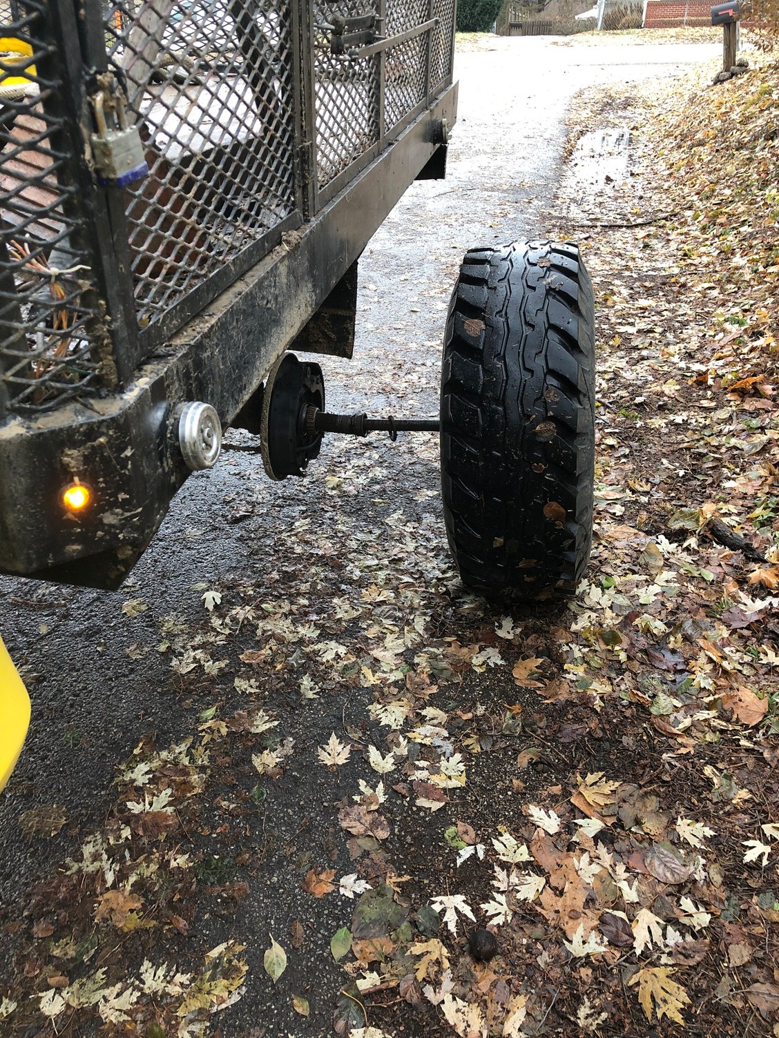

getting tired of this. It happened once before, same wheel. I replaced nuts and no more issues. Today, did the exact same thing. What gives, why does it keep doing this??

D60. This time ate the outside bearing. We swapped it out on the side of the road, now gotta order nuts and washer,, again, so I can get it back on the road.

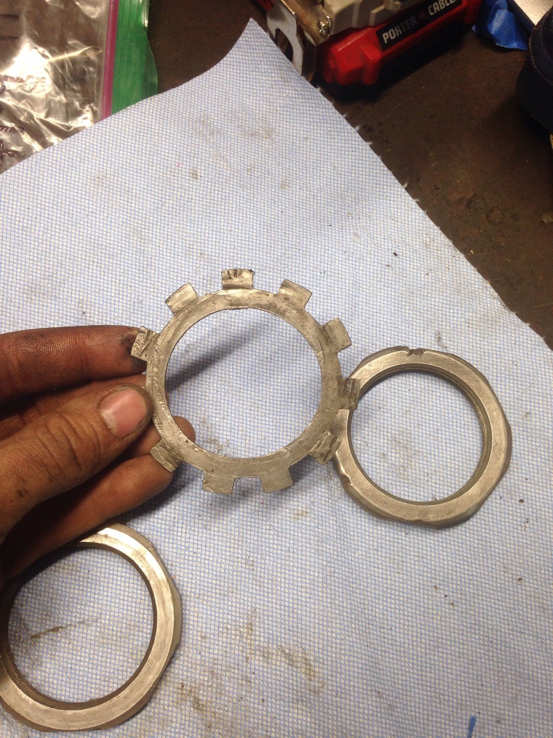

Ha I Just liked this picture on your instagram and thought "hey I think I saw this truck on fte". Anyway read the comment I left. Same thing happened to my highboy and I replaced the adjustment nut/tabed washer/lock nut set up with a single self locking nut off a 90s 10.25. I heard they only used the single locking but on the left side though
Ypu should have a lock washer like this between the two nuts

Nut-washer with tabs-nut
last time, the tab on the washer that sits in the keyway was sheared off, this time the same thing. I replaced the washer last time and tightened them correctly.
Im going to look more into the newer style
