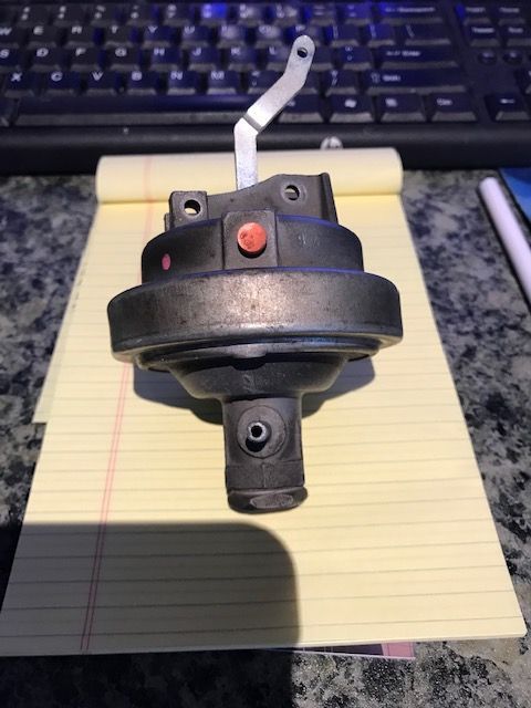

I wish I had looked up "how to post pictures". Yes the current vacuum advance has the spring spacer and shims, but it is of a later dual diaphragm design and does not utilize hard lines. It has one vacuum port on top of the spring, spacer and shims housing and a factory installed "orange" rubber plug on top of the rear diaphragm. I like the unique capability to externally adjust the advance. Just a little trick way to make adjustments with out tearing into the distributor.

pics of vac advance

Pretty fancy, thanks for pics!
