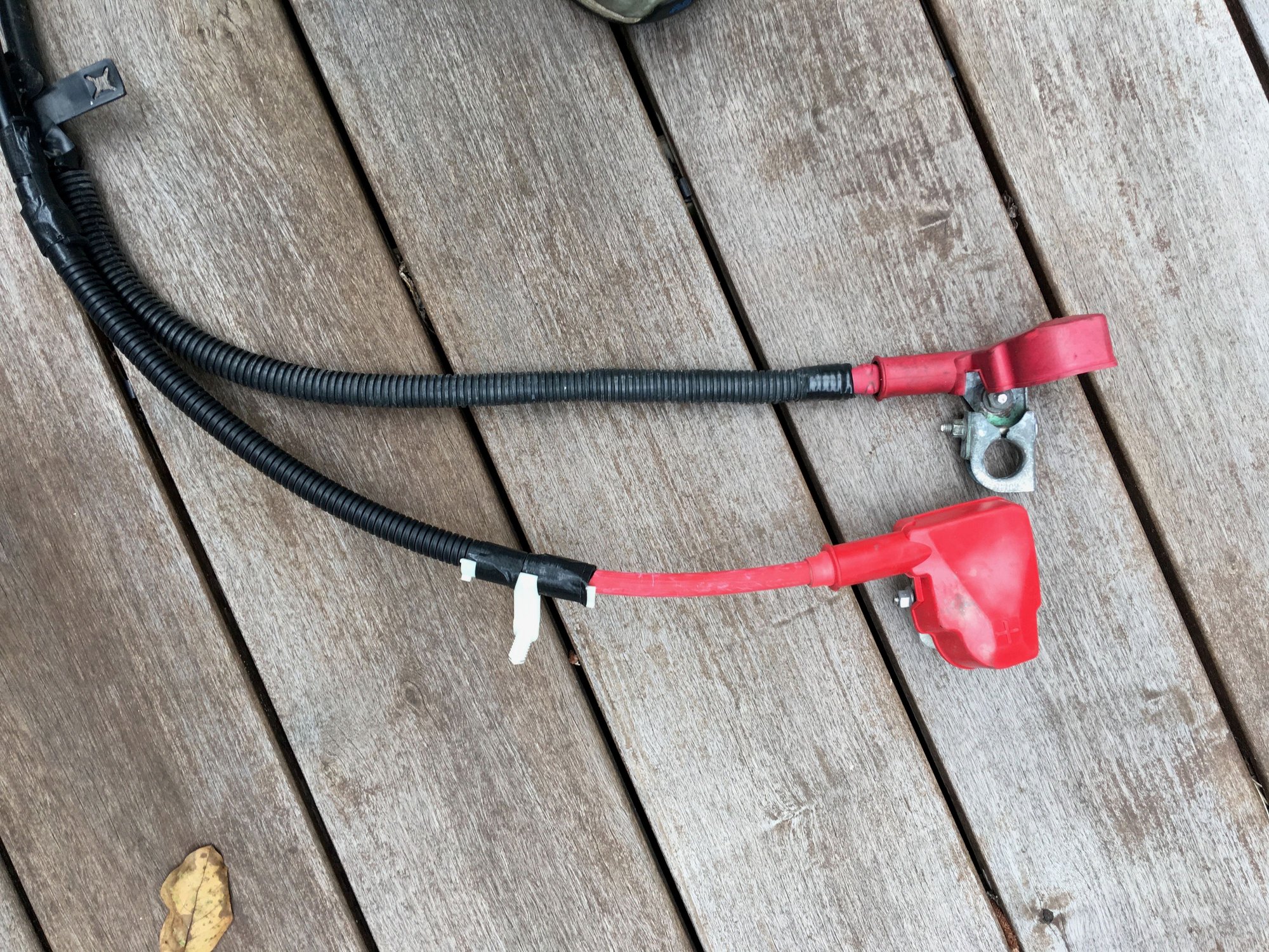

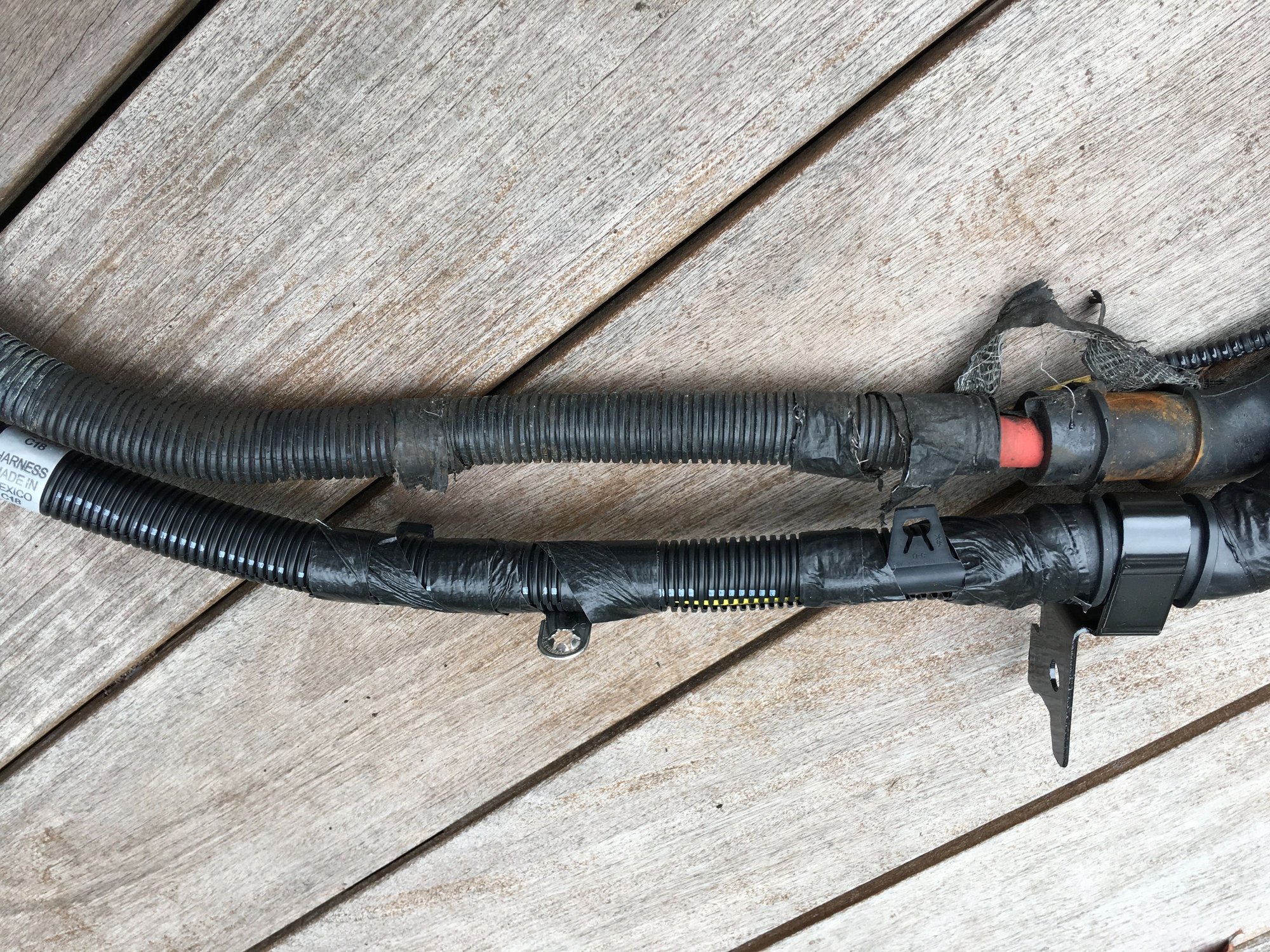

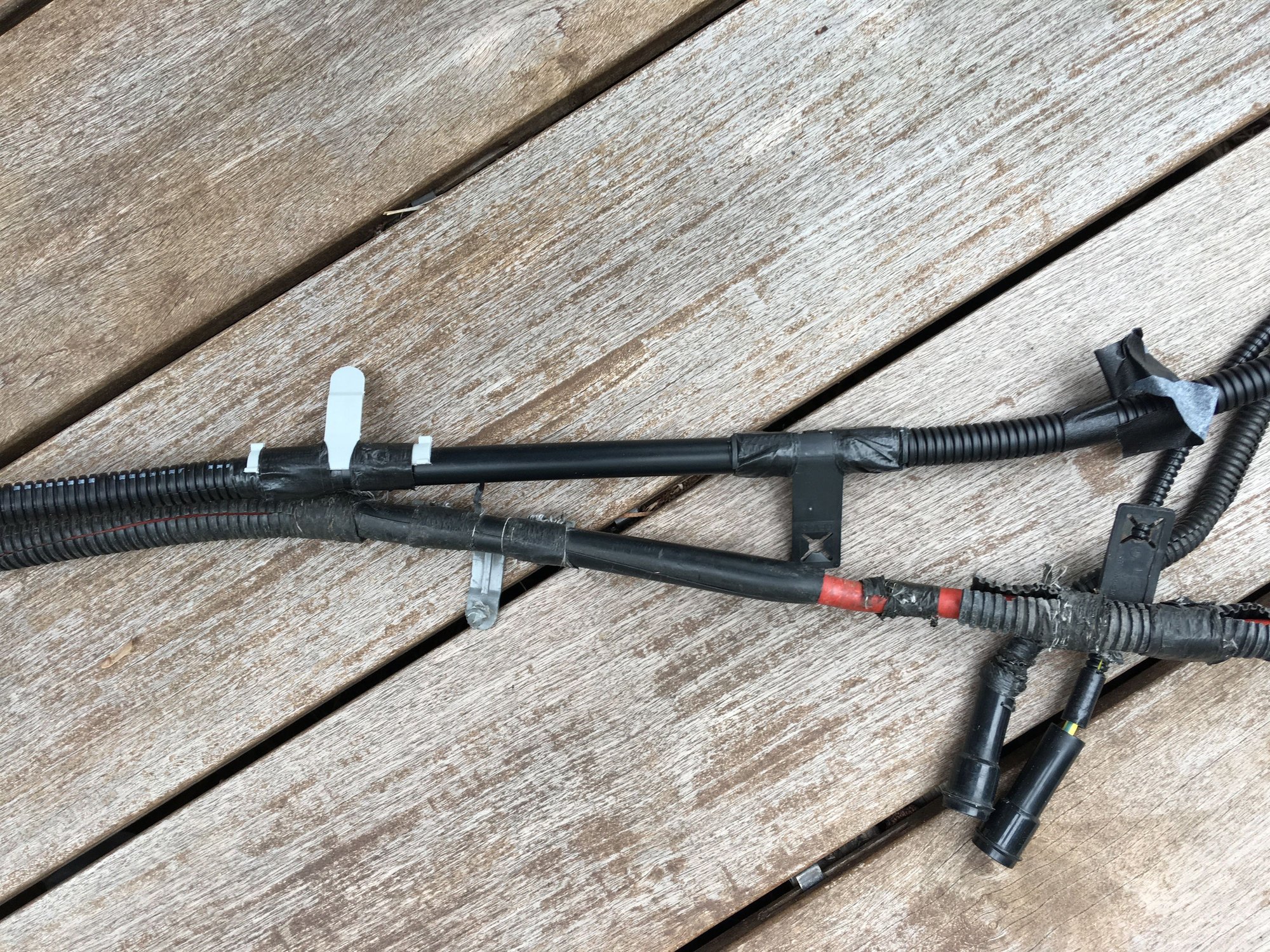

Here's what I had comparing my old '03 harness to a '05.

Thanks for the visual. At the end of the day, as long as the terminal connections are made, I'm good with that. Securing the cable is not rocket science.

All terminals, all cable sizes and all cable lengths were the same. And the major bracket at the 90° turn at the block mount was the same.
