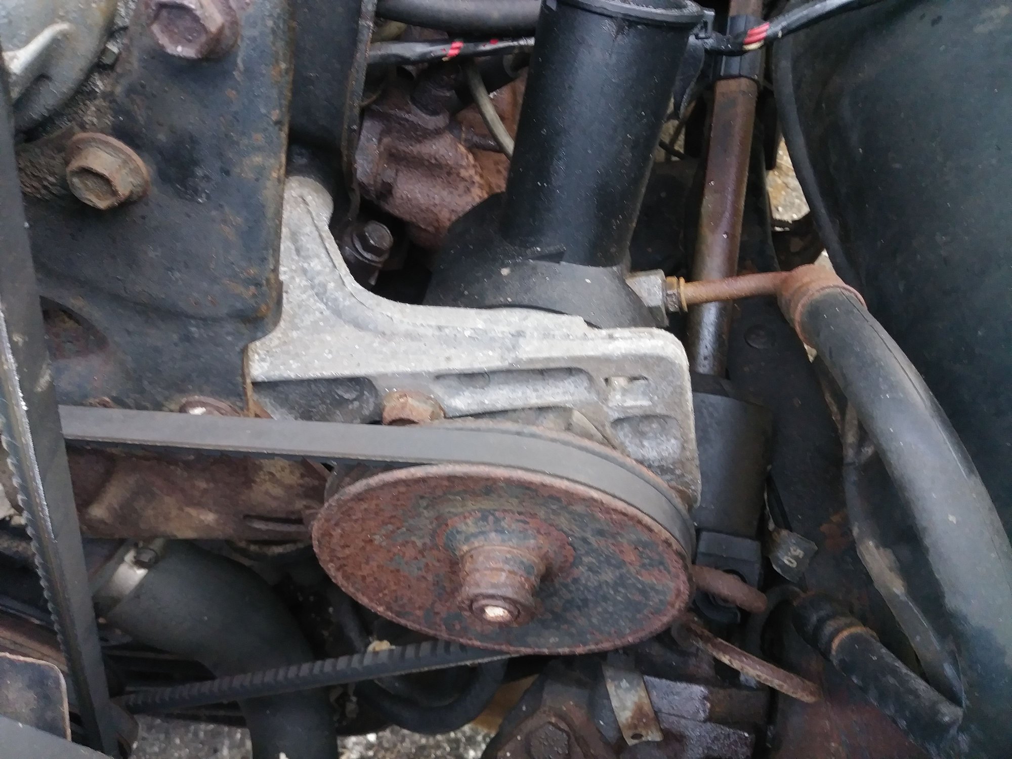

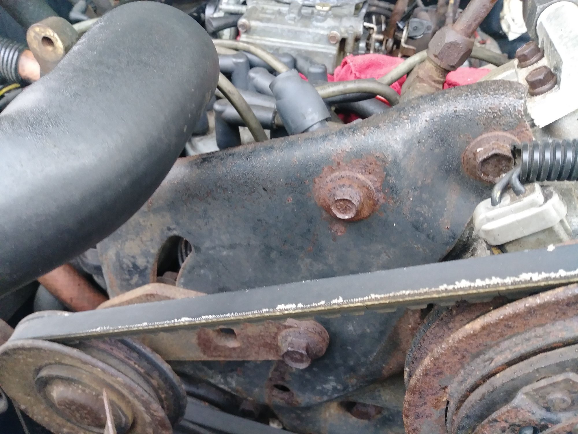

Ok, From what Im reading here you are looking for the correct brackets, then you also say you would like to "Tidy" up things because the brackets you have dont do that. It wont be that "Tidy" with factory ones. I have a 85 f250 with the 351 HO in it. If you want "tidy", better off going after market
The p/s bracket isnt to bad, but still a solid piece
The A/C bracket is huge, heres half
The other half of the A/C bracket
Alt bracket connects to the Smog pumps, After market is just a couple of sleeves that the bolts run thru.

Thank you very much for the pictures!!!!! Funny enough those are the brackets I have and I guess they’ll have to do. I was looking at the one I have for the smog pump and figured that’s what was missing. In my head I guess I wanted it to look much “neater” but it is what it is. I’d rather spend money on more useful items instead of going aftermarket. Again, much appreciated.
