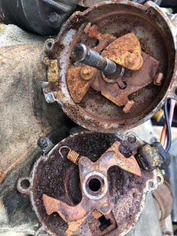

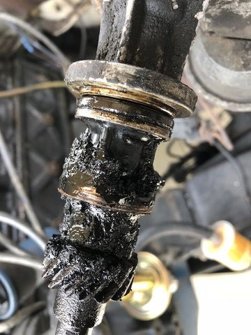

Had an issue with truck starting. Turned out to be a bad connection.
While trouble shooting, pulled my distributor, for the first time.........:
WD40??????
Distrib gear
Sooooooo. Went with an HEI conversion. One wire, dropped in today. So far so good.

Umm, was that distributor pulled from the titanic? I'm running the skip white HEI no issues so far.
I ran a summit branded one (same thing, resold as summit) for about 5 years in a mustang no problems.

Wow. I’m impressed. Love to see the guts.
Im running a Summit HEI. I like it

Truck wants to live. Got impressive / disturbing pics of inside my valve cover and what worn suspension looks like as well.
Got mine from Amazon. Looks like same as Summit / Skip White. Good to know. Thanks
