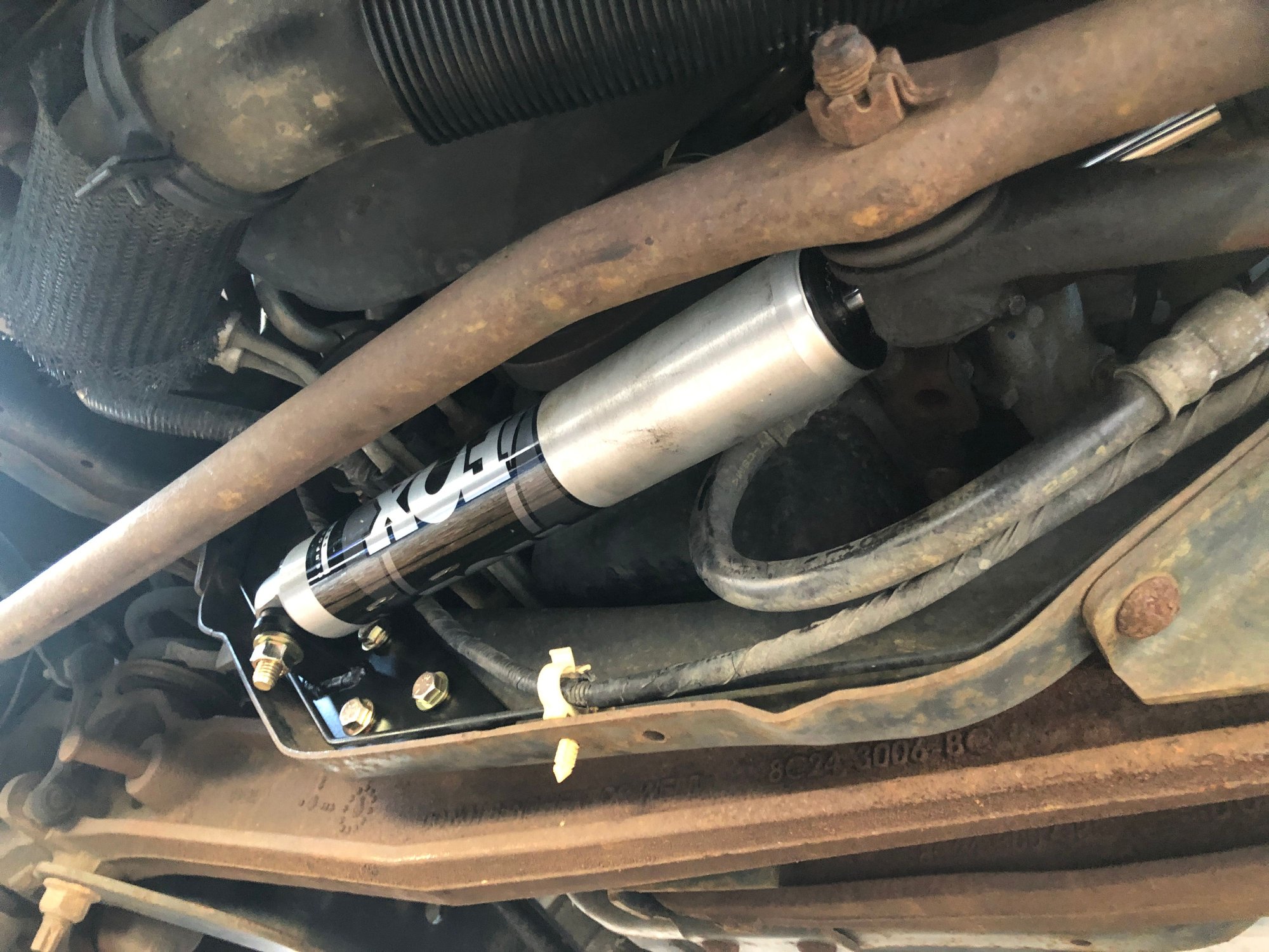

Finish the install today. I had to drill 4 holes in the frame, that was a major pain in the rear, but besides that it was straight forward.
Drove it an the ride is much better, still I need shocks but getting there.
