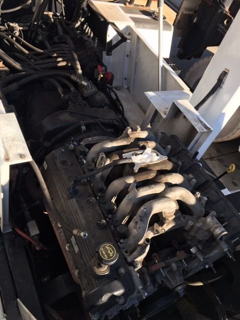

Pics
Here’s the pictures for those interested.

Can't see a picture but we have a Wiggin's forklift with a v10, common for marine use. We use it for loading high voltage tower assemblies on to trailers.

The lift next to the one being worked on also has a V10. We have three others with Ford 460s and the small one has a Ford 300.
