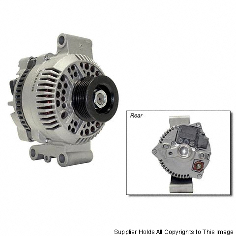

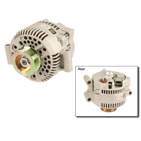

When I did the 300 to 351 swap, everything I used to do the swap was same as the factory set up, except that I used a 130 amp alternator from a '95 E350 with a 351. Externally it looks exactly like the 90 amp unit for an F150 with a 351....
90 amp alternator for a '95 F150....
130 amp alternator for a '95 E350....
The pulleys have the same 6 groove design....although there is an available 8 grooved pulley for the heavier duty models....
