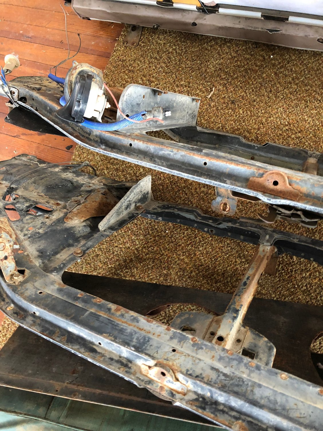

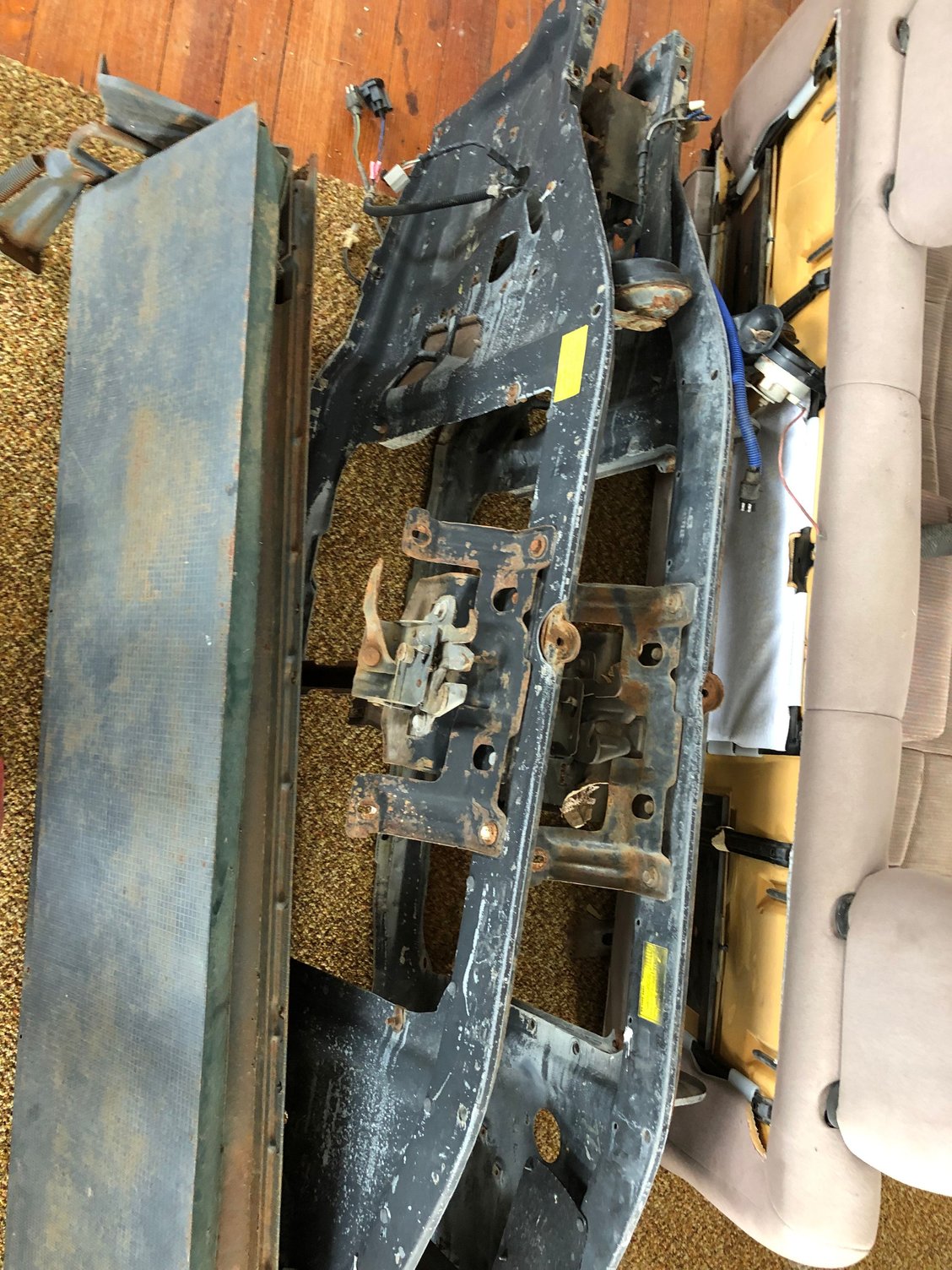

So is this the difference between core supports or is this just a difference in years.
My support is the black one that has the mounting bar go all the way up. I have extra supports where they just have the little triangle at the bottom (sorry for poor description) but I know they care off a later truck
My truck came with a regular radiator but I have a super cooling radiator in my parts pile

Thanks for the pics fordguy. I just posted that question in another thread (maybe one of yours?) that numberdummy was involved with too.
I was curious under what circumstances the different mounts were used. I've had the large Super Cooling radiators for fitting both types of mounts. Found out the hard way actually, when I bought my first replacement it was of a type to utilize the lower style in your pics with the full height flanges as part of the core support.
Had to re-order a different one and got the one to fit my support that has just the holes with speed nut clips (or whatever they're called) and the radiator itself has the mounting flange as part of the side supports.
Interested to hear the answer to that one that's been a mystery to me.
For the record, mine is a '79 F350 4wd that came with a radiator of unknown size.
When I bought the truck it had a standard sized radiator. I noted it and the owner said that he thought it had the super cooling radiator originally, but when the truck had overheated and needed a new one while he was on a trip, they replaced it with just what was available.
According to NumberDummy's comments in the other thread, the support openings were different sizes for the different radiators. I had not known that, so will measure mine tomorrow and that should clue me in on what it had originally.

@NumberDummy can you confirm why there are different radiator supports in my pic? Is the one for a super cooler and one for a regular or is one a 73-77 and the other 78/79? Or what? Is the only difference for a 74 radiator support and 74 super cooling radiator support the opening size?

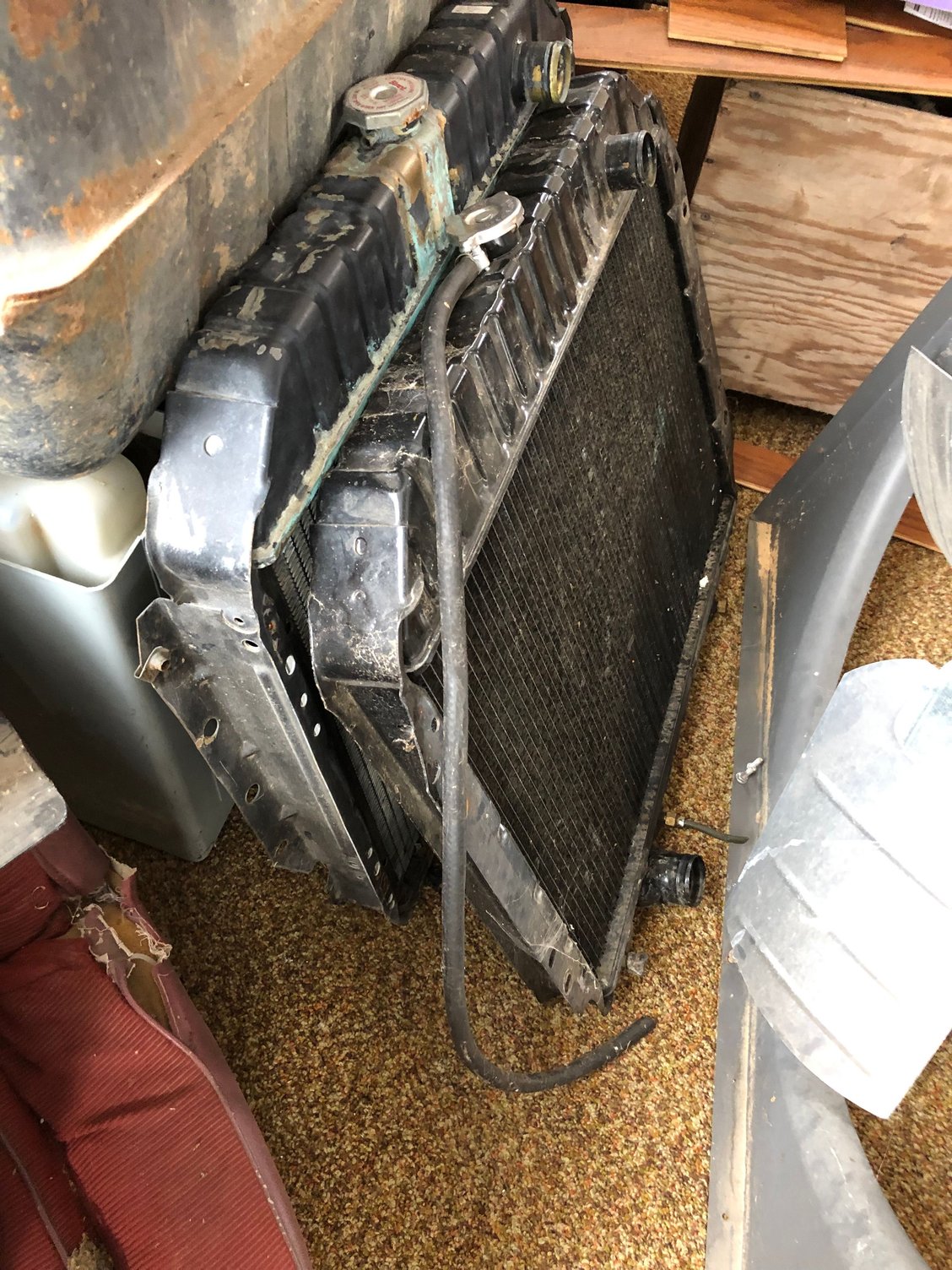

The 79 f350 I bought for axles had 9/16” studs on rear and 1/2” on front. I swapped fronts for 9/16” and it was a pita to find the right ones. Also had to buy new rotors after the first redrilled ones started cracking.
as for core supports, there are different size openings and different mounting points. One has a radiator that uses the front flange, other uses rear. I have some and will get some pix shortly.

Hmmm so the mounting brackets correspond with the core support... wonder why they used different versions. Design change or 4x4 vs 2wd or just random... wonder if number dummy knows
Thanks for the info! Apparently all the radiators I have (4) plus the ones I've paid attention too all had the rear mounting set up. The pics of the radiators helped clear that up!

These both came off of 4wd trucks. Not sure why the difference, both radiators in pic are regular, my super cooler isnot pictured
