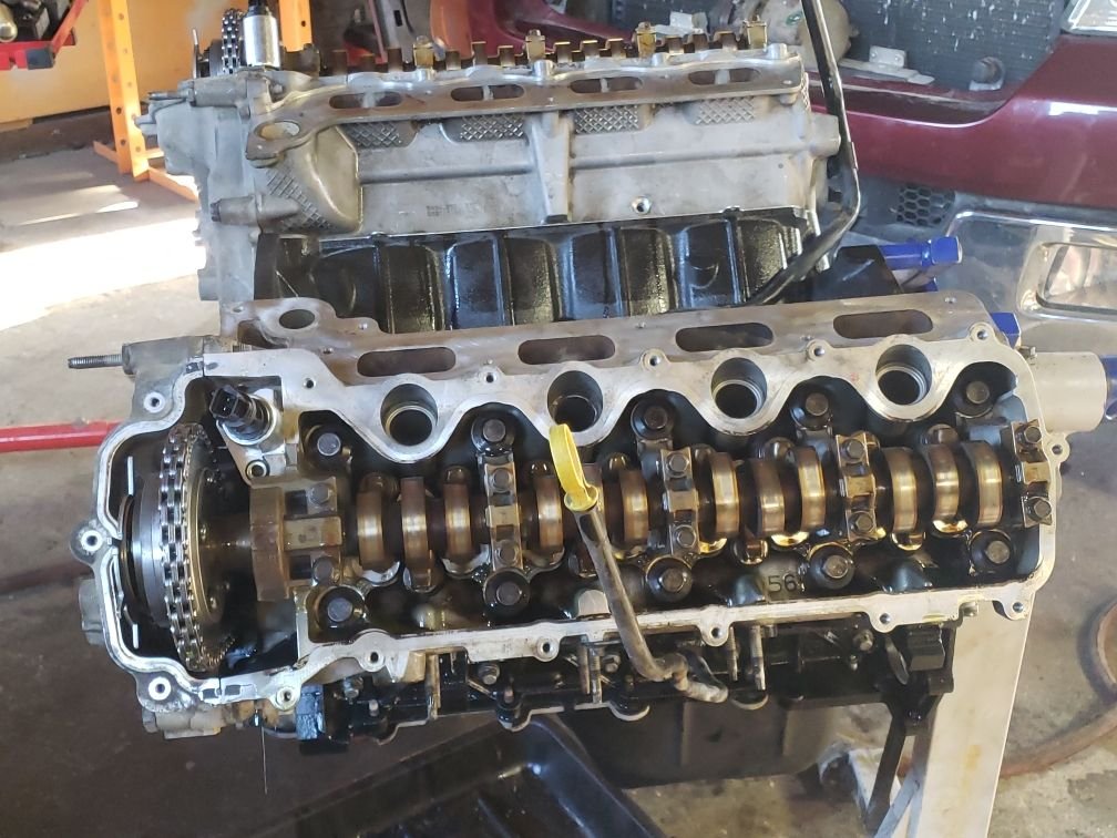

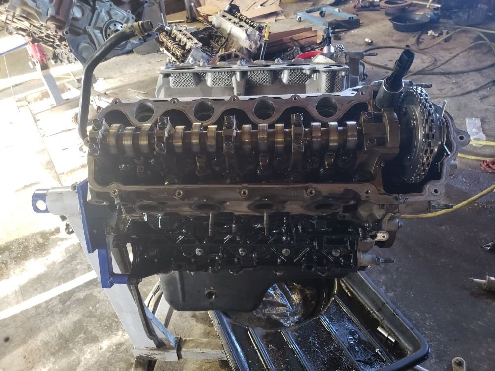

Got an update from my buddy a little bit ago. Motor Is done. He's working tomorrow and dropping the motor to get caught up so he can get to other jobs. Fingers crossed. He also sent me a few pics of the motor as he put it together.

Caution. Don't be too sure. I tried to blow up one of the above pictures with every piece of software I got - and can't see the Mfg / Part # on either one of those Phasers. I sure hope they were pure OEM Ford phasers. Throwing a P0340 or p0345 code right after a timing job is NOT a real good sign. Possibly failing to plug in a cam position sensor is all it is.
Good Luck.
