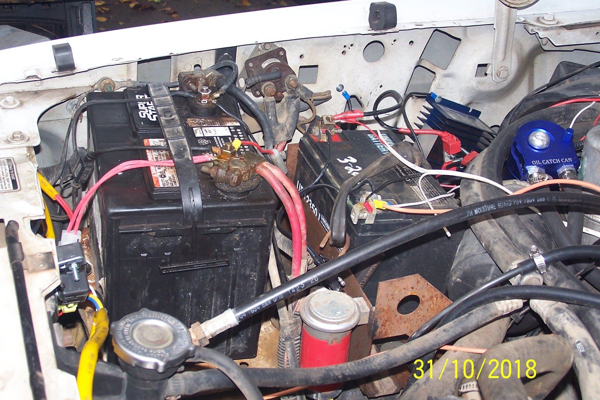

I would be interested in checking out your dual battery install.

The 2nd battery is to run my ham radio gear and add on's. It is a 35 amp hr sealed battery Could go larger or even a small car battery.
