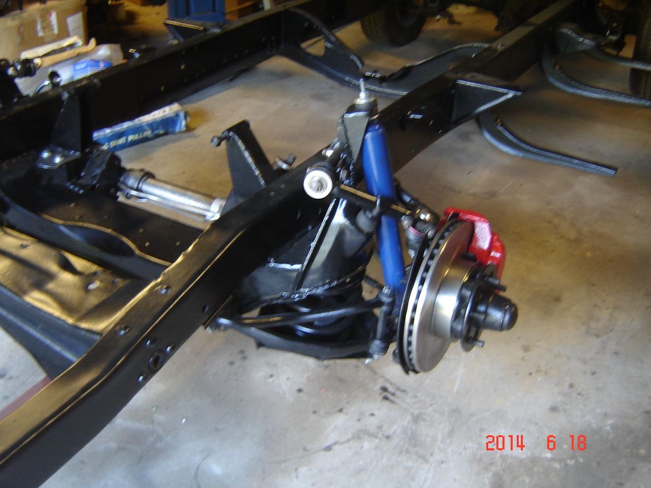

I've got about 15k miles on my 48 with a jag ifs. So far so good. I spaced the lower spring plate down with a couple of washers to lower it slightly. I did a complete rebuild before installing it. It handles just fine and has a smooth ride. Much cheaper than a MII. It's also a talking point at car shows. No one ever guesses what it is.

If you want to see how easy it is to install a Jag IFS check out my build thread. I did the same thing that RHooper did.
