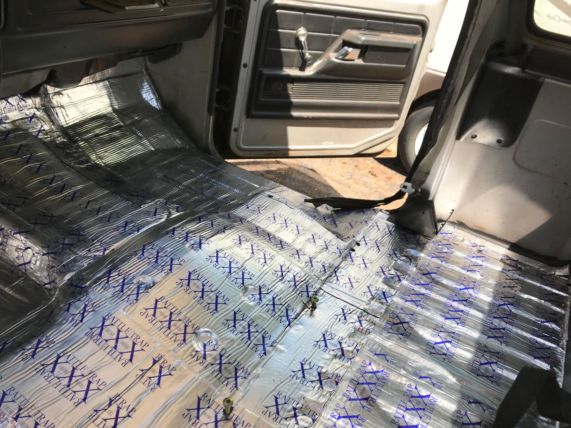

I buy this stuff on Ebay called Rattletrap. It's basically Dynomat without the huge price tag. I lined the whole floor of my '79 supercab when I fixed the floors in my truck.
Jess
