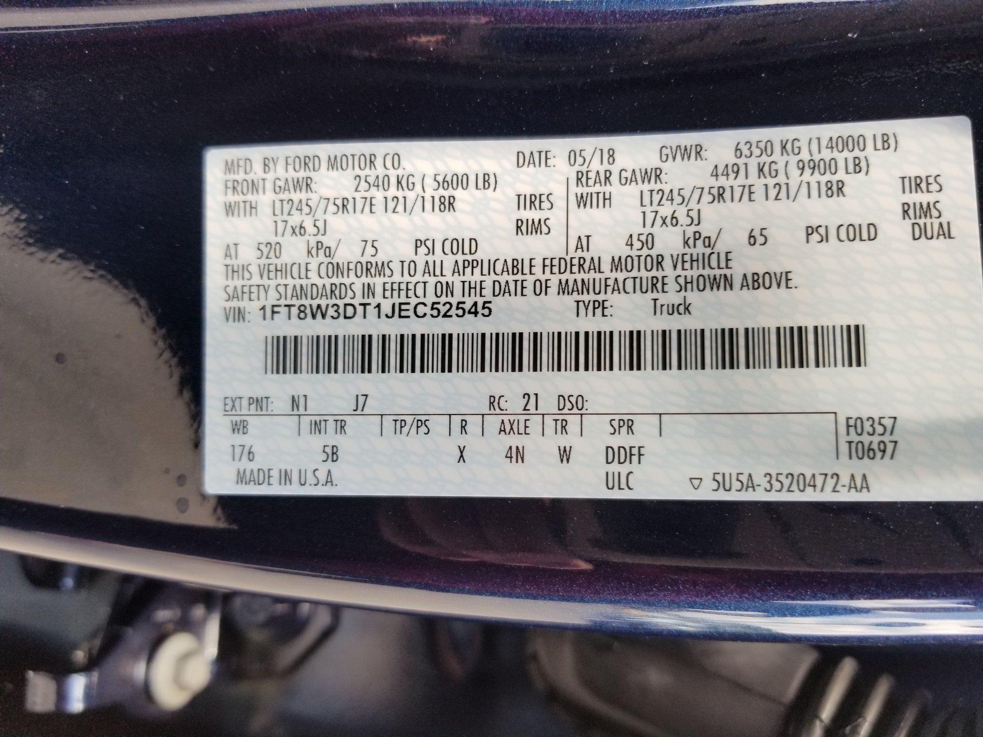

At least on my 2018 one of Fords options was for a 14,000 payload, rather than the 11,500 (note top right entry).
That sticker is a Dually, at 14,000 GVWR. And just so you know, you don't have 14,000 lbs of payload, you have a GVWR of 14,000 lbs. Payload on that truck, depending on how it's equipped is in the 5200 lbs and maybe on up to 6100 or so.

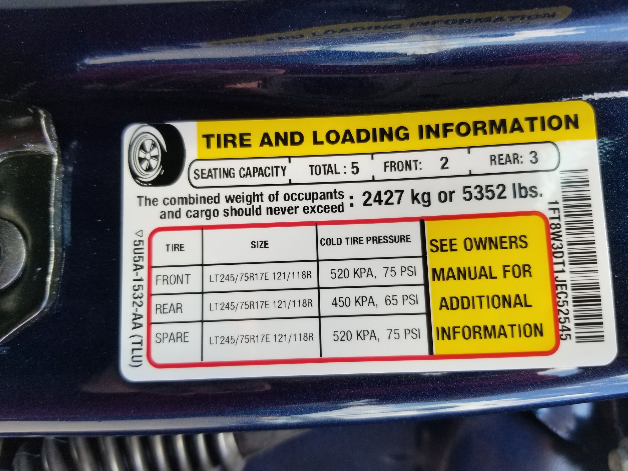

You are correct, I mislabeled it as payload when it should have been GVWR. My payload is 5352 pounds.

Don't go off of that 5352lb number. As it says - that is the fully loaded capacity with everything including people loaded to the truck. You would have to calculate backwards from everything you add to the truck to figure out what your legal pin weight capacity is.
Use the formula Senix posted of 20% of the GVWR of the 5th wheel as a starting gauge as to what to expect. How you load the trailer and where you put things will affect that (if you fill the basement with batteries for boondocking power you can expect that pin weight to be higher, for example).
If you are cutting things close on capacity with an SRW truck then bounce up to a DRW. If you are doing any extended trips regardless I would suggest a DRW no matter if your pin weight is way under the capacity. They are just more stable trucks to pull with all around. If you are in the territory of overloading the DRW trucks then you may want to look in to a class 6 or class 7 (Sportchassis makes a nicer converstion of a Freightliner M112, for example, and you can build an M112 all the way out to a class 8, though the Sportchassis are "lighter" and nicer riding).
The weight ratings you should never exceed on a truck are the rear axle weight capacity and/or the tire weight capacity (for a DRW add up the 4 rear tires, a SRW just the 2). Which ever number (tire total or axle) is lower is the ruling number. This will likely put you over the GVWR of the truck, if you load your rear axle to close to/at capacity, but a lot of people do it and are fine. Though, the big question is what happens in an accident - is an insurance company going to make a stink about being over a particular weight rating, GVWR or otherwise? I wouldn't want to find out. Best to play it safe and stay within all of them.

I believe that I can go off that 5352 number. I can load it with myself, my bride and my dogs - and lots of feathers - or lots of bricks, and/or a camper. Anyway I chose to load it that is what Ford says I can (legally) place on it.
Allowing 4k pounds of my 5th wheels 16K loaded weight (25% - not yet achieved) still gives me ample allowance for me, my bride, my dogs, my grill w/ propane, and a few tools (maybe 700-750 pounds). With the knowledge (that I may be lightweight) I load my fifth most heavily toward the front. We're only recreational campers, not full timers.
