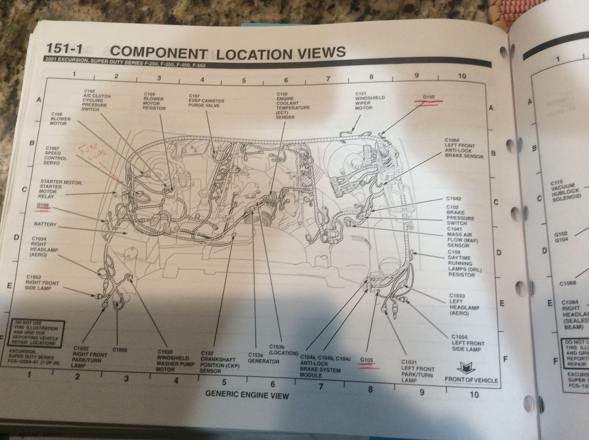

I've got a Chilton's manual, but electrical info in it is weak. Yeah, there's circuit diagrams, but not as good at telling someone where the physical parts are located. So, if you folks with more knowledge don't mind a little additional help:
- Also, where are grounding straps? I've heard those may be source of problem.
- Fusible links? How many are there? Where?
Only other thing I can think of is that it's been slow to start for a few weeks. I work 28 days on (overseas) and 28 off, and I attributed it to that. But now I'm wondering if there might be a relation.

I underlined the grounds for you and noted the fuse link.

That’s awesome ... do you have one for gas engine? Mine’s the gasoline V10. They’re probably similar locations, but might miss one. Thanks so much.

I deleted the 7.3 pic and posted the generic 6.8

Fwiw G100 is the PCM ground and the one that’s most often causes quirky intermintient function issues.
I would remove the bolt, clean all surfaces and reienstall. One installed spray with a battery terminal protectant to guard against corrosion.
