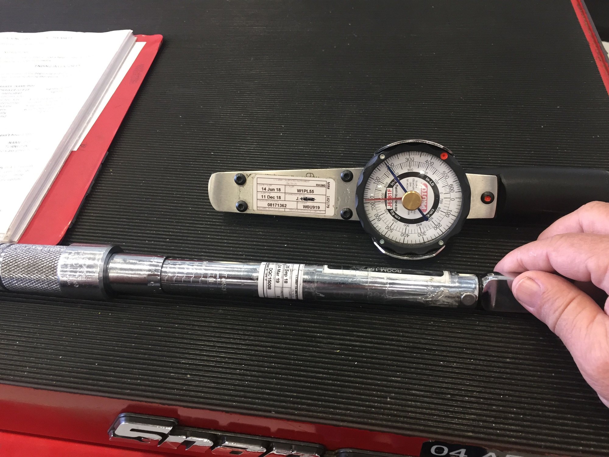

On my job we just send them out. Local PME lab takes care of them, 6months schedule I think and if we drop one more than 24in it gets recalibrated. Both of the wrenches in the pic are Proto but we have tools from many manufacturers so... I have in the past just sent in my home wrenches and they manage to come back to me. Sweet!
