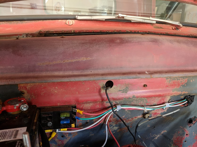

Nothing found so far on the Center Firewall. It's covered in the typical years of dirt and grime.

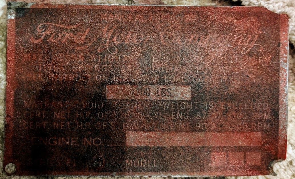

I am however working on the glovebox label that was painted over. I'm slow removing the paint and I can now read some of the lettering. I see Ford MoCo, "Engine Number" "Model" no actual numbers yet. Maybe more tomorrow.

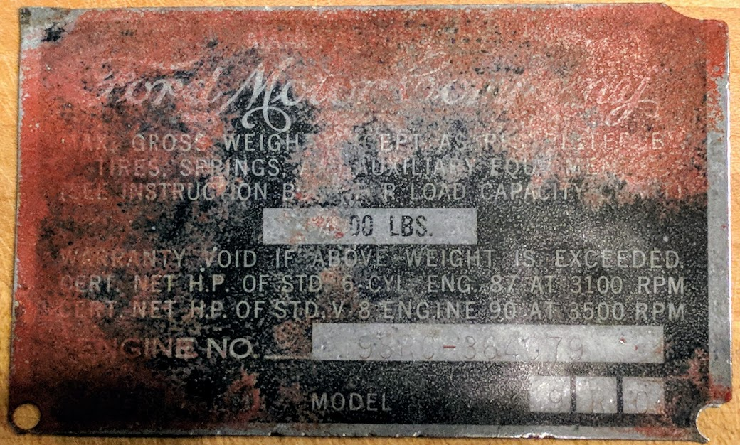

The numbers on the glove box tag are stamped very faint.

This was solid red when I started. Steel Wool, Paint Thinner and a Hard head got it this far.
Model 9RC??? any significance? It's different than the 98RC in the actual VIN...

That model number is consistent with everything else you have. I'm always amazed how tough the original paint is - they had good stuff back then. The weight rating above the model # is 4700.
You may be right about the 29D Wayne, but that style of character..... pics from others would definitely help.

The center upper firewall has no markings that I can find,
