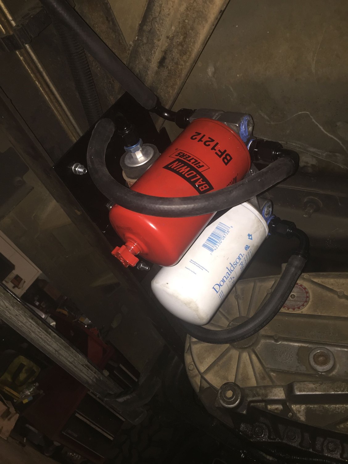

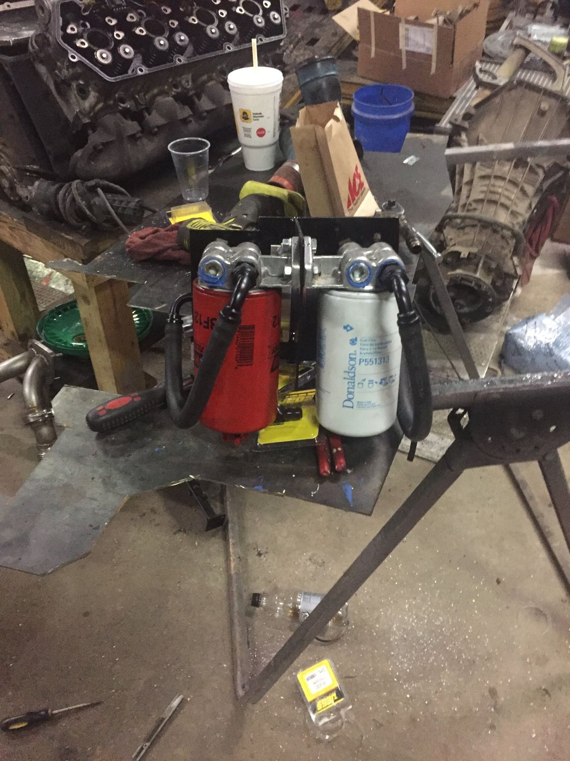

Best prices I’ve found on the filter based is go to eBay and type in wix filter bases. It’ll come up with the base and a filter combo that’s pretty hard to beat price wise. As far as a filter primer I’ve considered it myself but it’s not really necessary. Also I’d recommend using an fittings for the connections on the filter bases. I ran hoses and barbs on mine but I’m getting ready to swap out to an fittings and lines. This is the setup I built for my brothers truck using an fittings and pushlock I’m gonna use an fittings and braided on mine .
