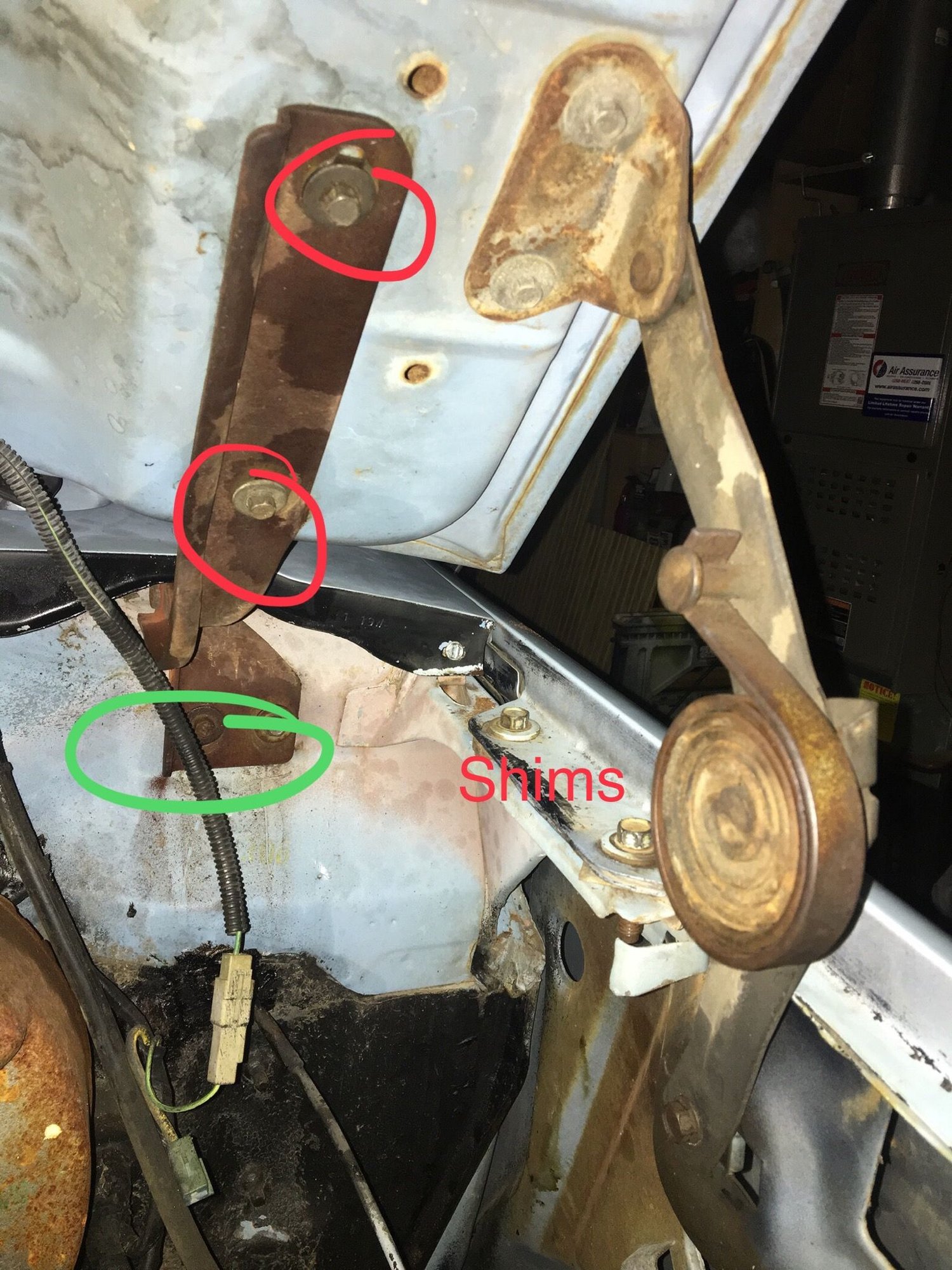

I spent the better part of the afternoon loosening bolts and tightening them back. I circled the hood bolts in red, they’re absolutely maxed out. I had a little luck with the hinge bolts on the fire wall (green) but it still has a pretty big gap...

The only other thing to do is make the slots longer.
Pull 1 hinge at a time and use a rat tail file to make it longer.
