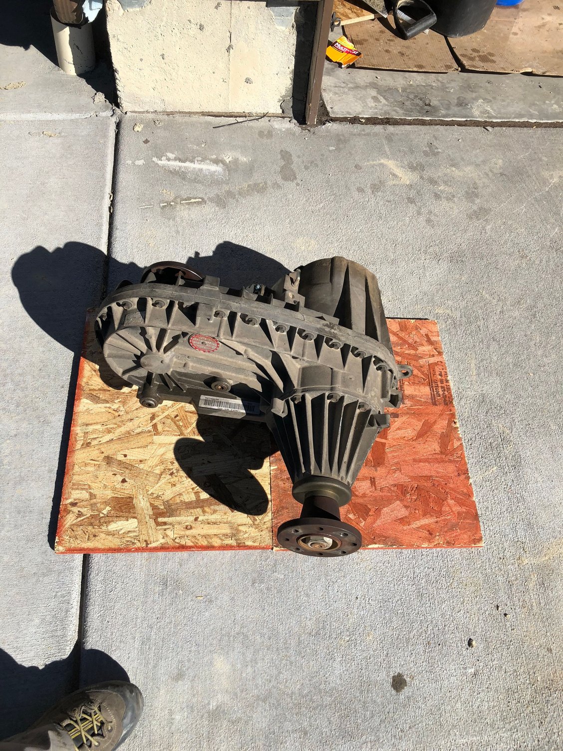

TC is out
Old Oct 13, 2018 | 11:43 AM
Squirrel13's Avatar
Squirrel13
Joined: Sep 2018
Posts: 1,115
Likes: 264
From: KY
