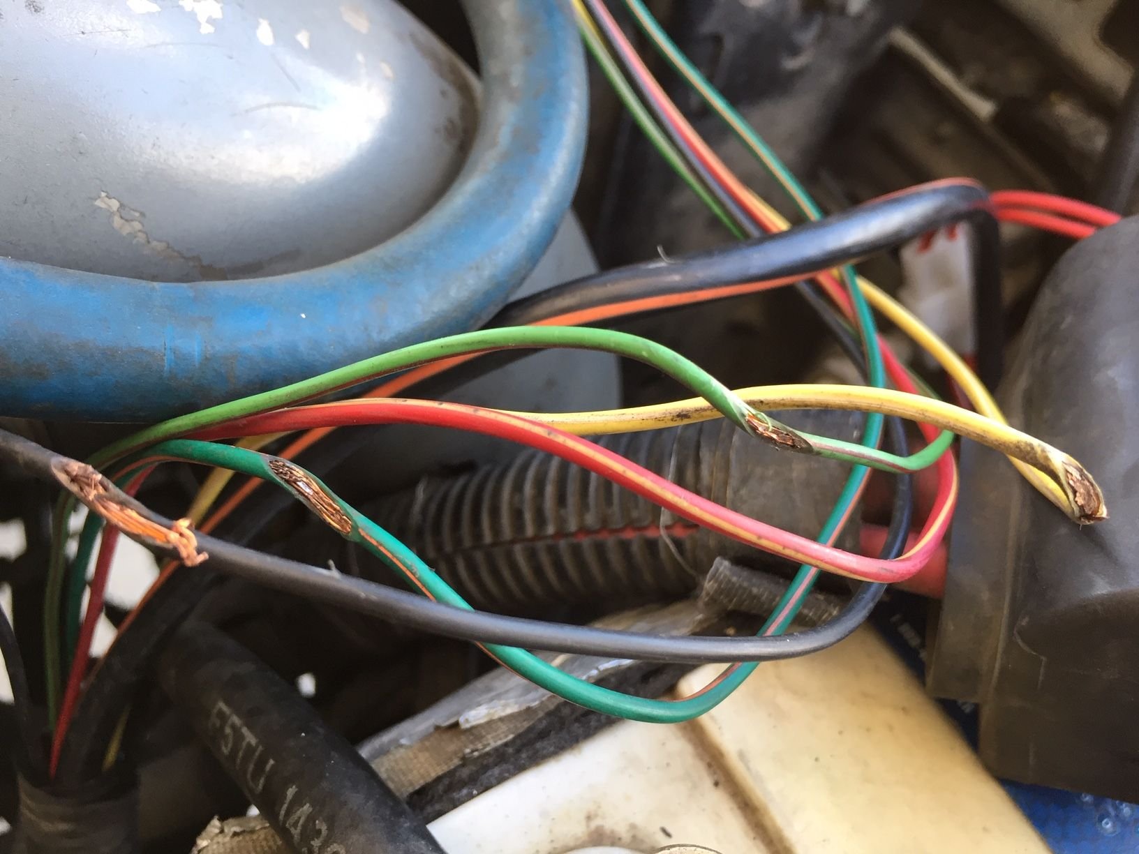

These are the wires that rubbed on the pulley.

you could probably get by with taping them, but i would cut, solder, and heat shrink tubing seal them.

At first I looked for a replacement harness. No luck except a used one on feebay for $80 that didn't look any better then mine zooming in on it. I'll do the solding thing. First, I have to get a broken tooth fixed .
