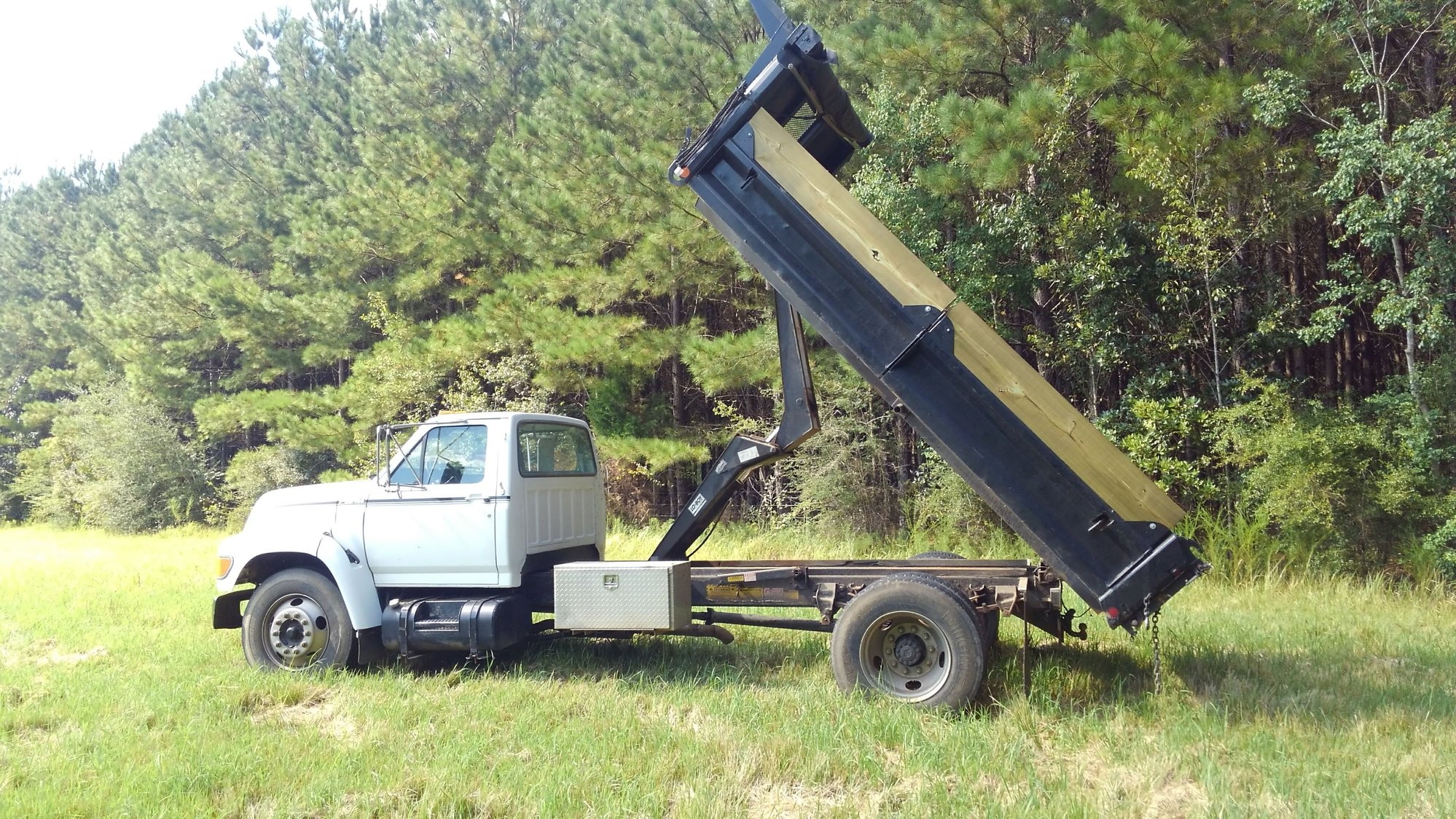

1999 Ford F800, 5.9L 24V Cummins, Allison AT545.
Anyone know if there a way to "bypass" or is there a fix to the engine being limited to 1500 RPM until the engine/transmission senses that I'm moving? While fully loaded, I'm having trouble climbing embankments such as driveways or RR crossing unless I'm already rolling. The 1500 RPM is barely above the stall speed of the torque converter. Once the truck is rolling, I get full power and all is good. I'm assuming this is normal as it's been like this since I got the truck about 3 weeks ago.
1999 F800, 5.9L 24V Cummins, Allison AT545 auto, 14' dump w/ fold down sides, 16T scissor lift.
