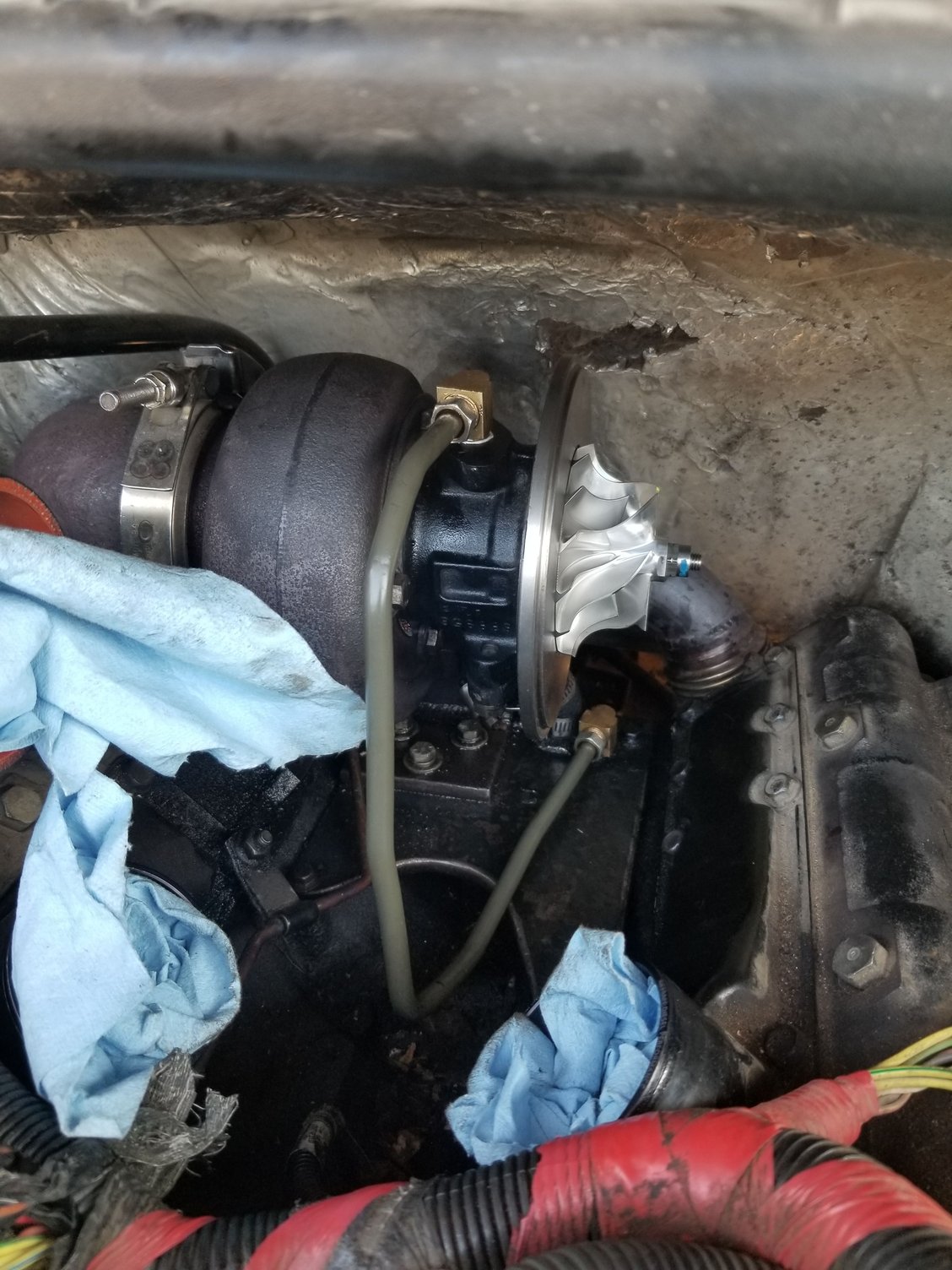

It helps a bit that the kit is custom so everything comes apart very easy. Plus Im a young feller, actually this was a birthday present to myself, turning 31 on the 8th.
Almost done with the install!

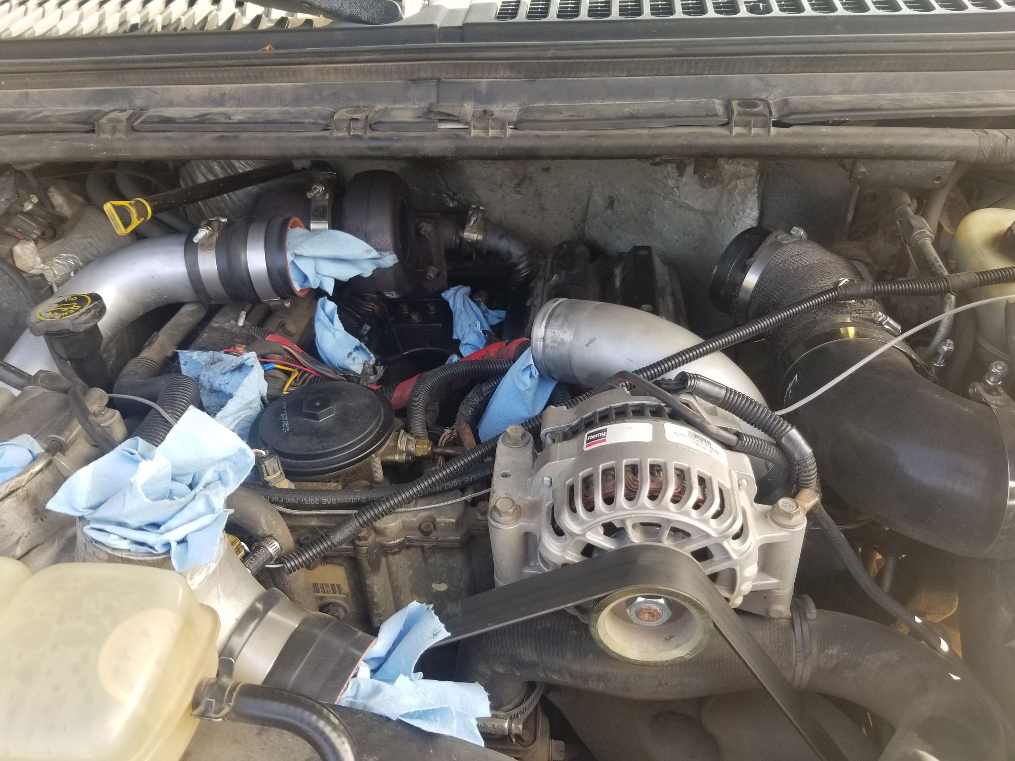

It fits!

Why did you take the compressor housing off if you don't mind me asking?

I'd clock the housing down a bit.
Took it off to inspect it, also a little easier to work around. Although the SXE compressor cover is shapes a bit different than the last turbo.
Had a small clearance issue with my up-pipe v-band clamp on the compressor housing. I should have loosened it and re-clocked it but I didnt. It is barely touching and is past the bellow so it wont be moving around rubbing more.
The damn up-pipe v-band bolt prohibited any more clocking. Something Ill fix at another time but I have to get ready for Field Trials now.

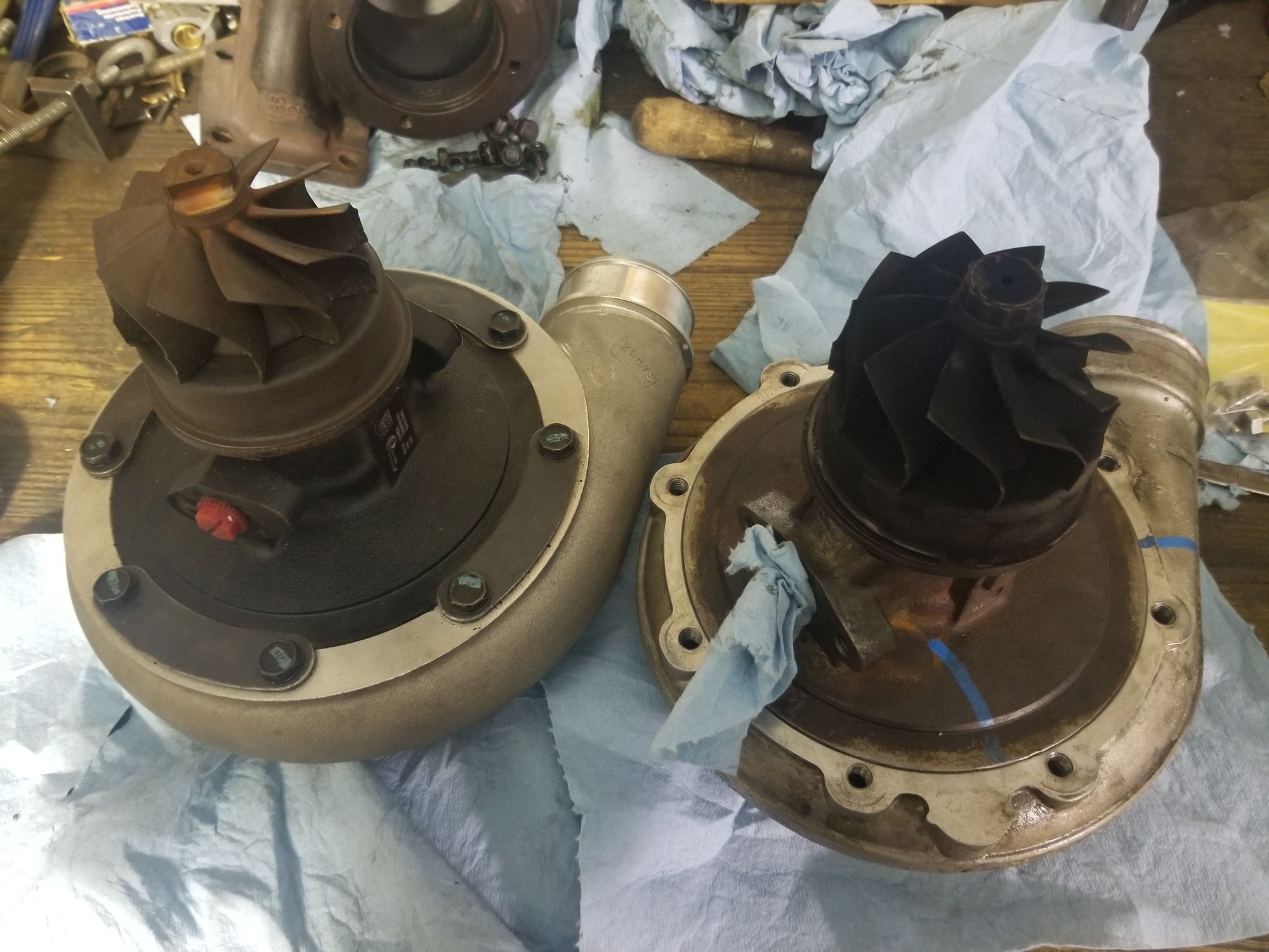

Originally Posted by akcooper9
Broke what PCM hex code do you have?
Also, was your 366 the non sxe turbine?
NVK4
The 366 has the SXE turbine but not the SXE compressor housing and wheel. Everything on the turbine side is the same. Here is a comparison of the 363 and 366 (on the right).
