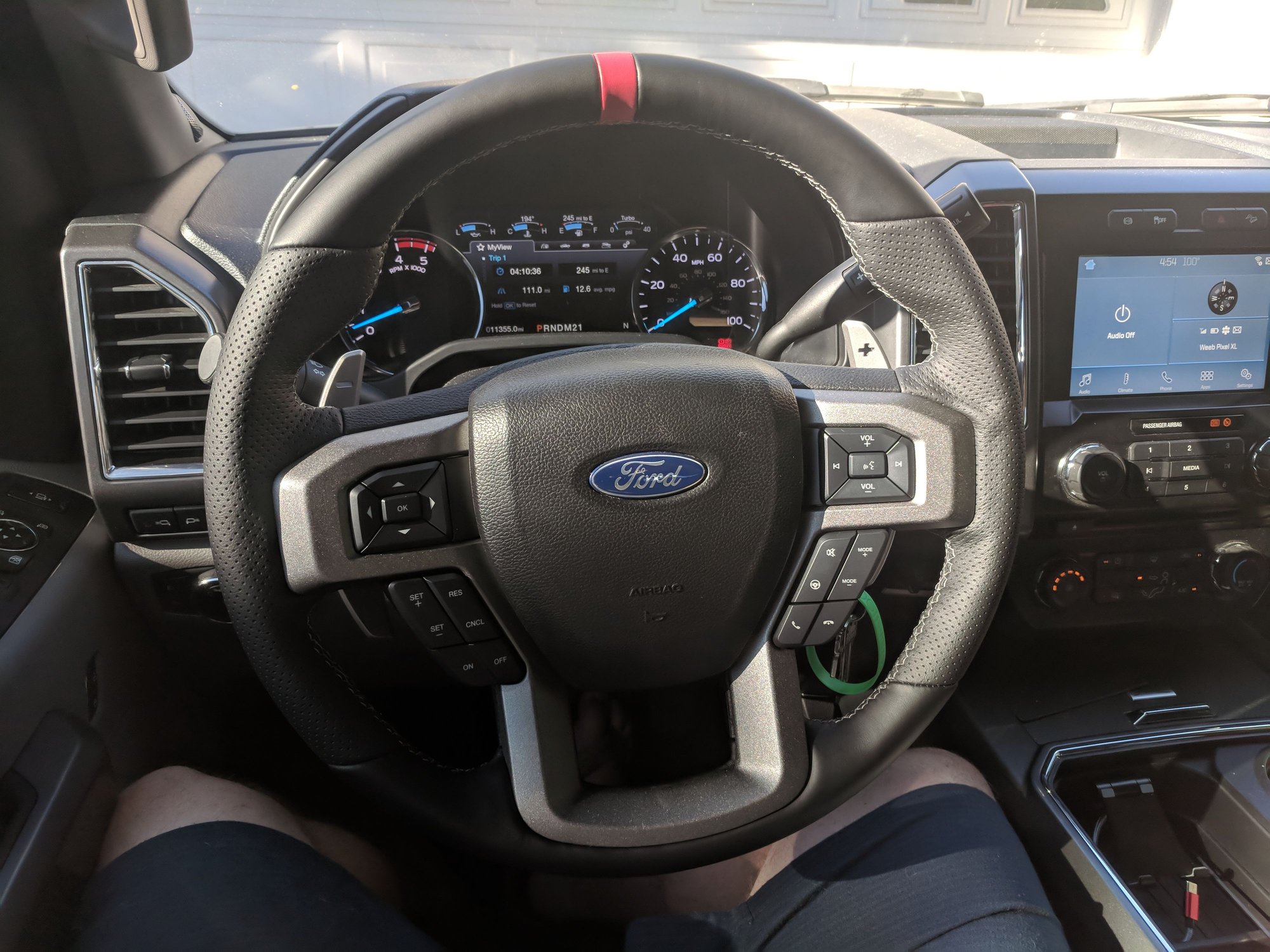

If you're feeling randy, the raptor wheel is the best feeling wheel I've ever felt (in a car that cost less than $250K at least).
As long as you don't have adaptive steering, pretty much any F150/F250 wheel will be a direct bolt on. You retain your current airbag, its just a direct swap.

The Raptor wheel is certainly nice, but I don't prefer the perforated leather. I like the smoother genuine leather. It does tell me, however, that an F150 wheel should work in an F250. Again, I'll check out some trucks on the lot and contact Fairway Ford with questions.
