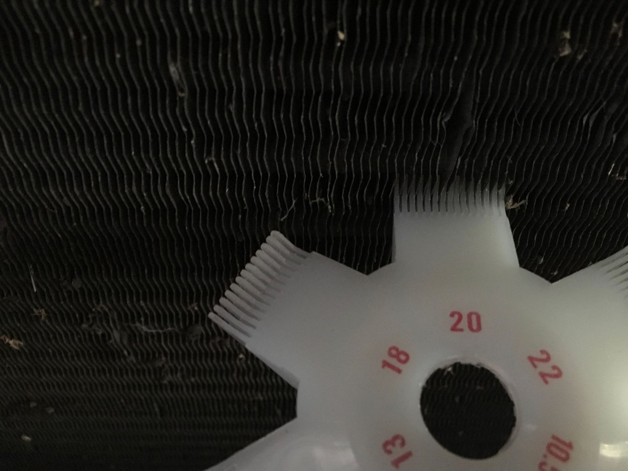

Bion has the info on fin combs.
Originally Posted by housedad
Wow, Sean. I just looked at mine and they don't touch. There were no rub marks on my old one. I did the hose changes as part of preventative 100,000 mile service/checkup.
As far as the comb. I have two types. One for dirty quick and very light straightening, and another for when I want it to end up perfect.
I got the quick and crude one at Home Depot. The links below are the ones I have.
Quick and dirty
For work I care about.

Those combs are for plate fin coils only. If your condenser coil is that bad, best to replace it as it's probably blocking too much air flow to the radiator.

20 fins per inch works best, just take your time when going over the bigger bends.

I ordered this one on Amazon. Should be here by tonight.

I drained the coolant and pulled the radiator. I also straightened lots of fins on the condenser. The condenser was in better shape than I first thought. It was just covered in insects from the long trip.
I flushed the radiator. There was some brown film in the top and bottom black part. But water flowed freely through it. It is definitely not the original radiator.
I also cleaned out the fins with a hose spray from the back on both the radiator and the condenser. Nothing too bad.
