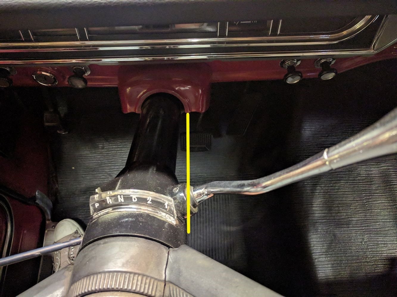

My truck - a 1969 F-100 - came with a conversion to power steering. As the original gearbox was junk, I replaced it with a nice Redhead unit. Bottom line, it appears as though there is not enough room for this unit and so it is deflected about - I would say - 1" (Pic 1).
Result: My steering column isn't parallel and "leans" a bit towards the door (Pic 2).
I want to emphasize that my truck power-steers like a dream and it is only the OCD inside me that this bugs.
What do you think is involved in truing up my steering column? Thanks in advance.

If the body mounts are rotted away that will cause a mis-alignment if I am reading your post right.

In these trucks the columns typically lean toward the left a bit.

Thanks, this makes me feel better. Everything otherwise looks installed correctly and, as I mentioned, works very nicely.
