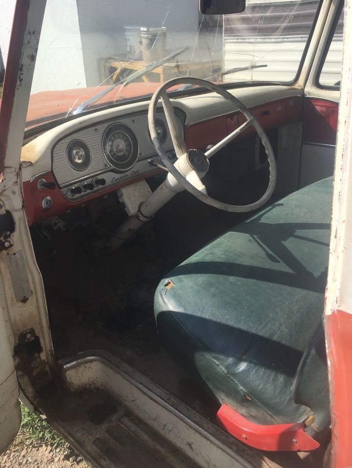

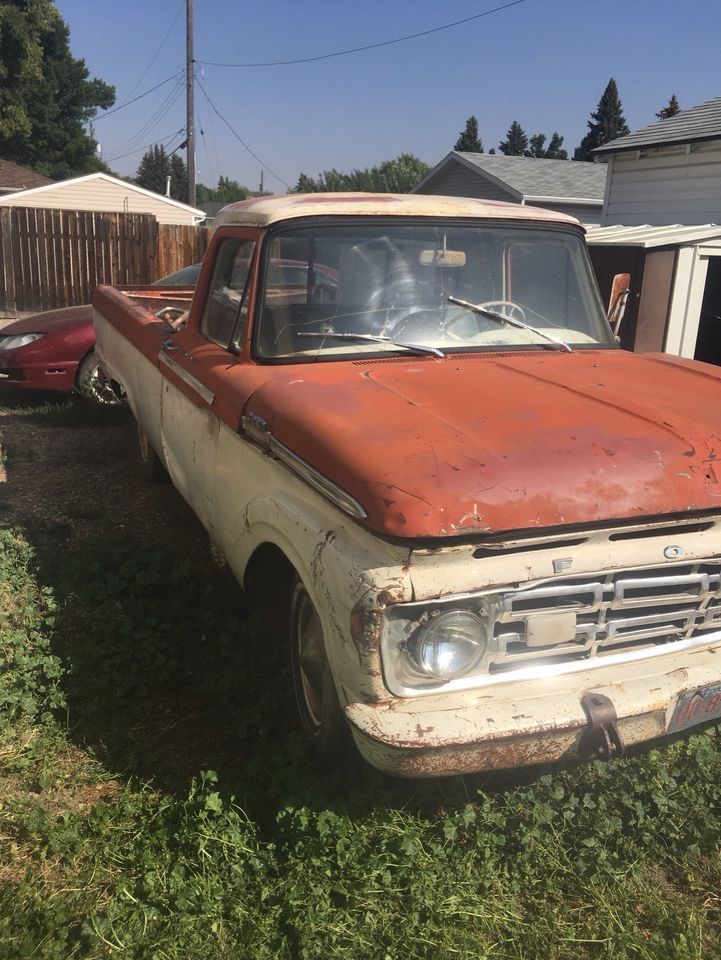

DanK4120 is the expert here. He has posted pics of the reverse tu tone trucks and plates

A perfect example of what I was talking about. Now about those hubcaps?

Another classic Canuck:
https://www.kijiji.ca/v-classic-cars...ord/1378298510
Reverse tu tone
Reverse dash paint

Not really reverse dash paint. The truck above is a Custom Cab and the primary color is white which says the instrument panel face should be the secondary (automatic or chosen) color and is another reason the 1966 F100 4x4 that is the subject of this thread seems wrong to me. Given the colors on the outside the area around the radio, glovebox and ashtray doors and anything around the gauges and ***** (below the Custom Cab dash trim) should be blue. Insides of the doors should be white, steering column and wheel should be white, etc. etc.
