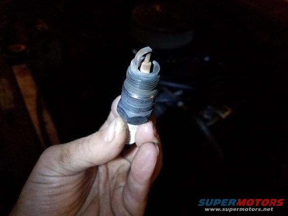

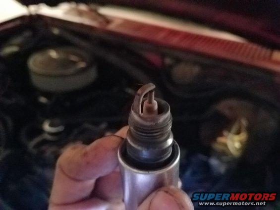

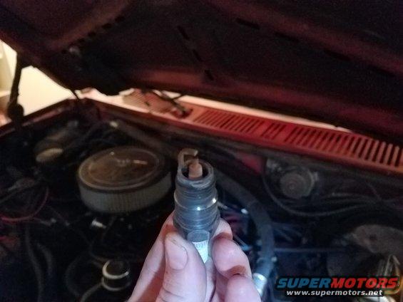

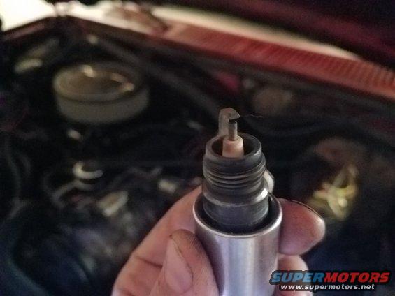

Okay, pulled the #1 and #3 spark plug, since those are the closest and furthest away from the Sniper.
Honestly, if I had laid them down side by side, I would not have been able to tell the difference.
