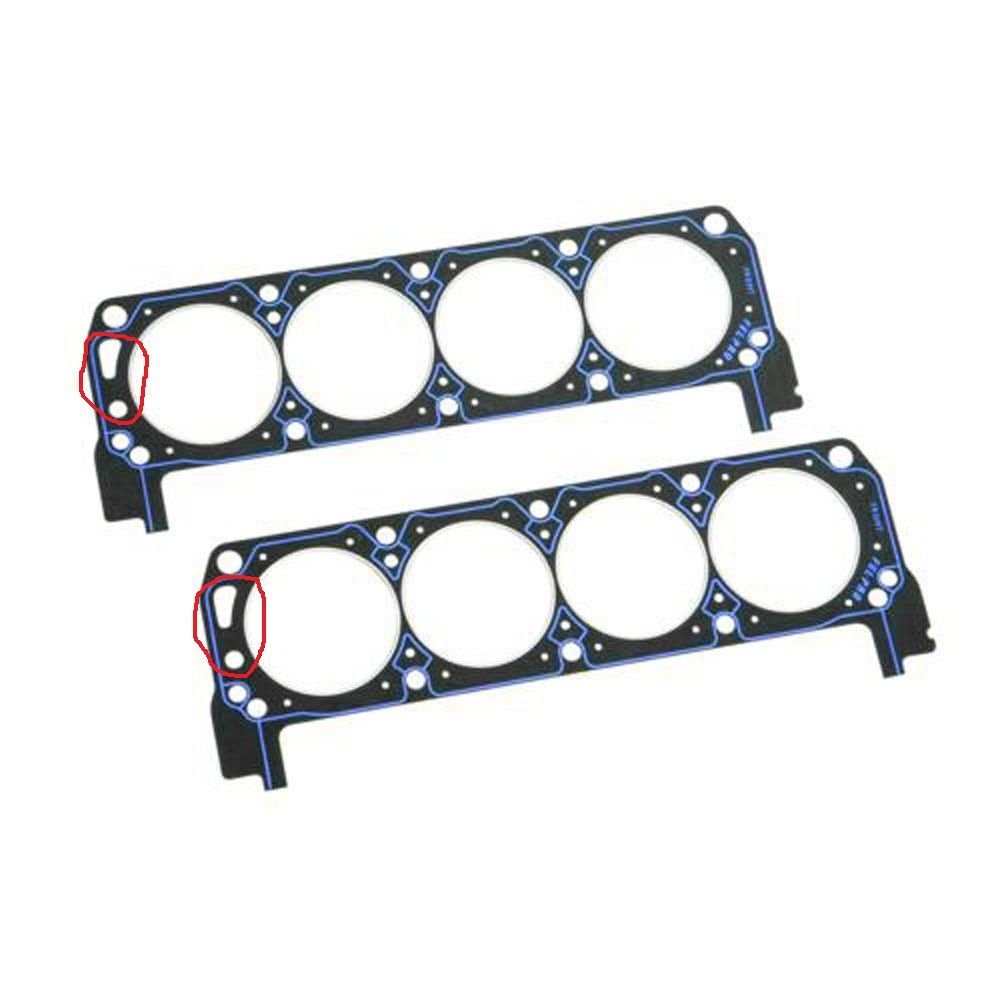

Originally Posted by Gigemags05
Can anyone comment on the pics above of the head gaskets? Can I eliminate a mis-installed head gasket from the possible cause?
If the gasket was on backwards, wouldnt it overheat pretty quickly?
Well not quickly but it would overheat.
What makes you thin the head gasket was installed backwards and upside down ? They are all clearly labeled front or top.
And we could not tell if the are installed right without knowing the brand of gasket...

The only reason i thought of backwards/upside down gaskets is from reading online.
I used fel-pro gaskets

Ok on the fel pro gaskets there may be gasket over hanging on both the front and back...
if you suspect the were installed upside down and backwards you can check this.
it will mean being under hood or under the vehicle with the engine running. And Ideally you want an infrared thermometer to do this.
TO give you an idea what you are looking for.
The head gaskets ensure the bulk of the coolant flow enters the head at the back of the engine. The coolant then flows the length of the head and exits in to the intake at the front of the engine then out to the rad.
If the gaskets are installed upside down and backwards. The bulk of coolant will leave the block at the front of the head and to the intake. . this prevents coolant from cooling the back of the block and the heads.
If they are installed upside down and backwards There will be a significant temp difference between the back of the block and the front of the block and significant temp difference between the front of the head and the back of the head.
With the engine up to temp. From under the vehicle feel the back back of the block and then the front of the block or measure using the infrared thermometer . If there is a significant difference in temp time to start worrying. The do the same from above for the heads. If the back of the block and the back of head are much hotter than the fronts then your head gaskets are in upsidedown and backwards.
Below is pic of a set of Fel Pro SBF head gaskets. The circled areas ALWAYS go to the back of the block or firewall side this is applicable to ALL Ford OHV V8's and pretty much all engines in general.
Also as you can see both ends of the head gasket will overhang.
Check this to rule out the improper installation of the head gaskets.

But...the engine still started creeping up to 225-230 after twenty minutes of idling in my driveway. The coolant started to overflow into the reservoir. I had an infrared thermometer and tested all over the entire engine the whole time with no noticeable differences between the front and the back of the block/heads or from either side to either side.

I am open to all advise on how to trouble shoot this. I don't think the fan is the issue, as it was running the whole time and the engine still slowly crept up above normal temp. I don't imagine its the head gaskets being upside down/backwards since the temps on the block and heads were all similar. Any other ideas?
