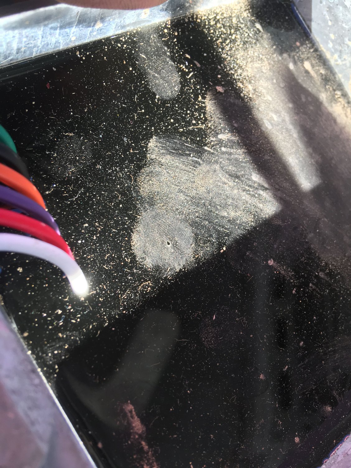

I come back after work and try to start it and she starts right up. The idle was pretty rough but I took this opportunity to get the truck home. I turned the truck off and decided to clean the carb up a little bit. After a while I had my girl start the truck up and it ran for about 1 minute before cutting off. No sputter or cough, just a clean cut off. That's when one of my buddies mentioned replacing the Ignition Control Module, located in the drivers side fender well. I went to the parts store and got a replacement (yes the color codes matched) and also got a replacement ignition coil. I took out the old ICM and noticed several holes in the silicone that the chip is inside of (I will attach pictures). I put both of the new parts in and the truck started right up and there was a noticeable improvement in acceleration, however the idle was still shaky and unacceptable. I figured I had taken care of my problem but boy was I wrong. I drove the truck about a total of 25 miles the next day before I started having the issue again. This time I had parked it at my work and it had sat for about an hour before I went to start it. When I started it, it was idling at about 500 rpm and very shaky. It ran for about 45 seconds like this and cut off just like before. Frustrated, I opened the hood and could see that the fuel filter was full of fuel, so I decided to unbolt the ICM from its spot and look at it. I noticed a small pinhole had appeared above where the white wire goes into the silicone on the back of the ICM. I then tried starting the truck again and it started right up.
It has not done anything questionable since, but this was just yesterday. I need to know what could be causing those holes in the silicone or if that is just normal. Also, could this actually just be an intermittent fuel pump issue? This truck has the dual tanks with low pressure electric pumps in the tanks. My gas gauge doesn't work and I think that is due to the replacement fuel tank selector valve either being faulty or not wired in correctly. I know that flipping the switch kicks the pump on for whichever tank is selected so I am thinking that this could also be a fuel pump issue or something wrong with that valve or switch. I want to bypass the valve for now but I don't know what to do for the wiring side of that task. This is my only vehicle right now and I am really regretting this purchase but I need to get it figured out. Anywhere in particular I should start looking? Anyone else had issues like this? Any help would be greatly appreciated.
Here's a photo of the old ICM. Note the several holes that look like they melted the silicone:
And here is the new one after 24 hours of use. Note the small hole that has appeared above the white wire.

I would agree, check for spark & fuel when it won't start. Not even attempting to start with a shot of starter fluid implies an ignition problem.
Don't know what to say on the small holes you're seeing in the ignition module but my suspicion is that they're unrelated to anything.
