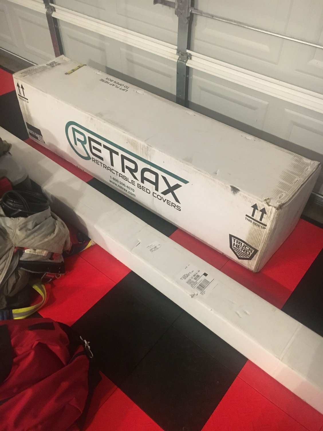

Mine showed up today. Now I just need a truck to put it on.

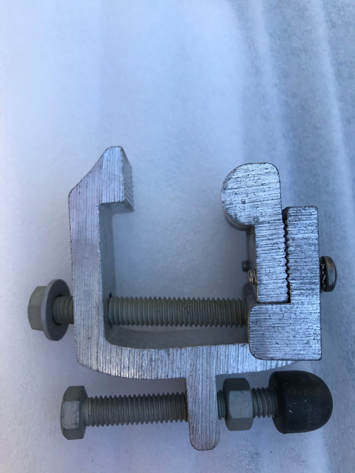

Has anyone installed theirs yet? I am wondering if they sent me the wrong clamps. The drawings in the instructions show a different clamp than the standard one for the xr rails. The rounded part should be angled per the instructions so it pushes up, it says to support the loads on the rails.
I installed it with these. I can’t quite get the weather stripping at the canister to be even on both sides at the front either.

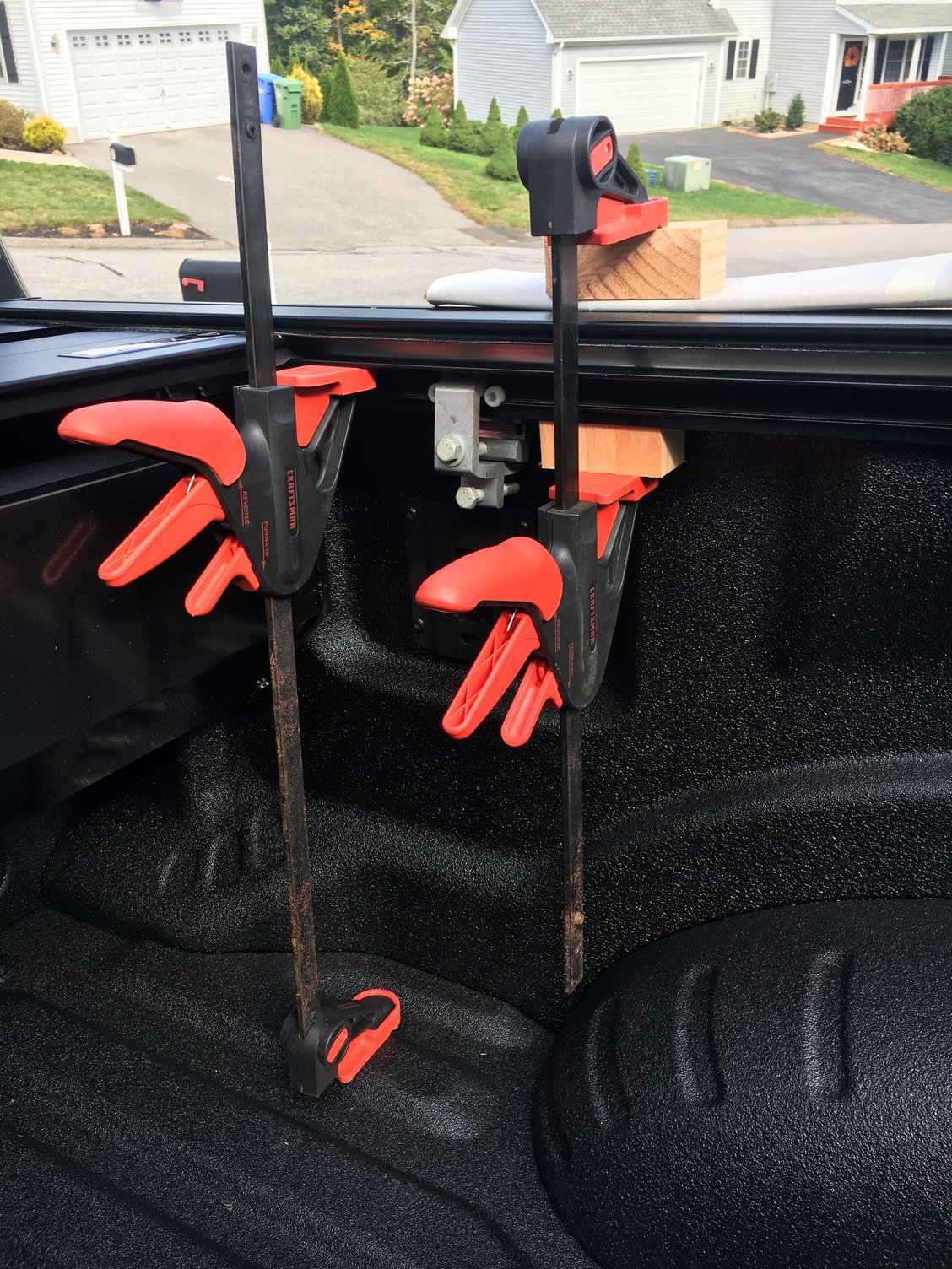

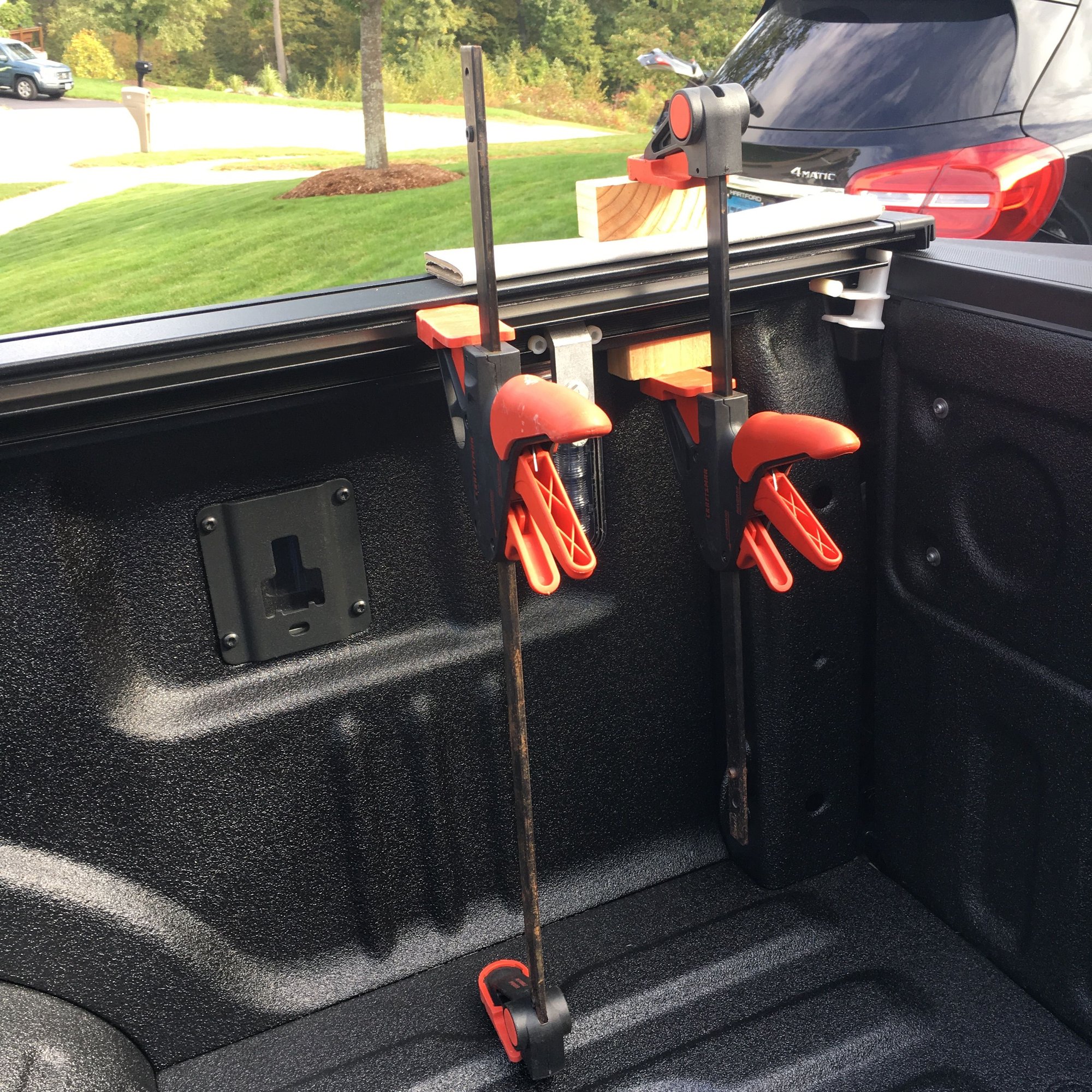

Those are pretty much the same clamps that I got with my XR. They will work. I had to extend the adjustable section all the way out. I installed mine today. I tried installing it while parked in my driveway which is sloped. I couldn't get anything to line up. I took it to the flat elementary school parking around the corner and had it dialed in about 20 minutes. Straight as an arrow, opens and closes easily. I used a couple clamps/wood blocks to get the rails tight to the bed and tilt them at the 2 degrees as the instructions said to do (see pic below). It would have been impossible to install this by myself without the clamps. Nice and tight too!

I emailed Retrax, and the clamps are the correct ones. I was told the vertical sliding part is what makes the clamps unique for the XR rails. The manual drawings are only shown the way they are to illustrate that the sliding part needs to be at the top.
