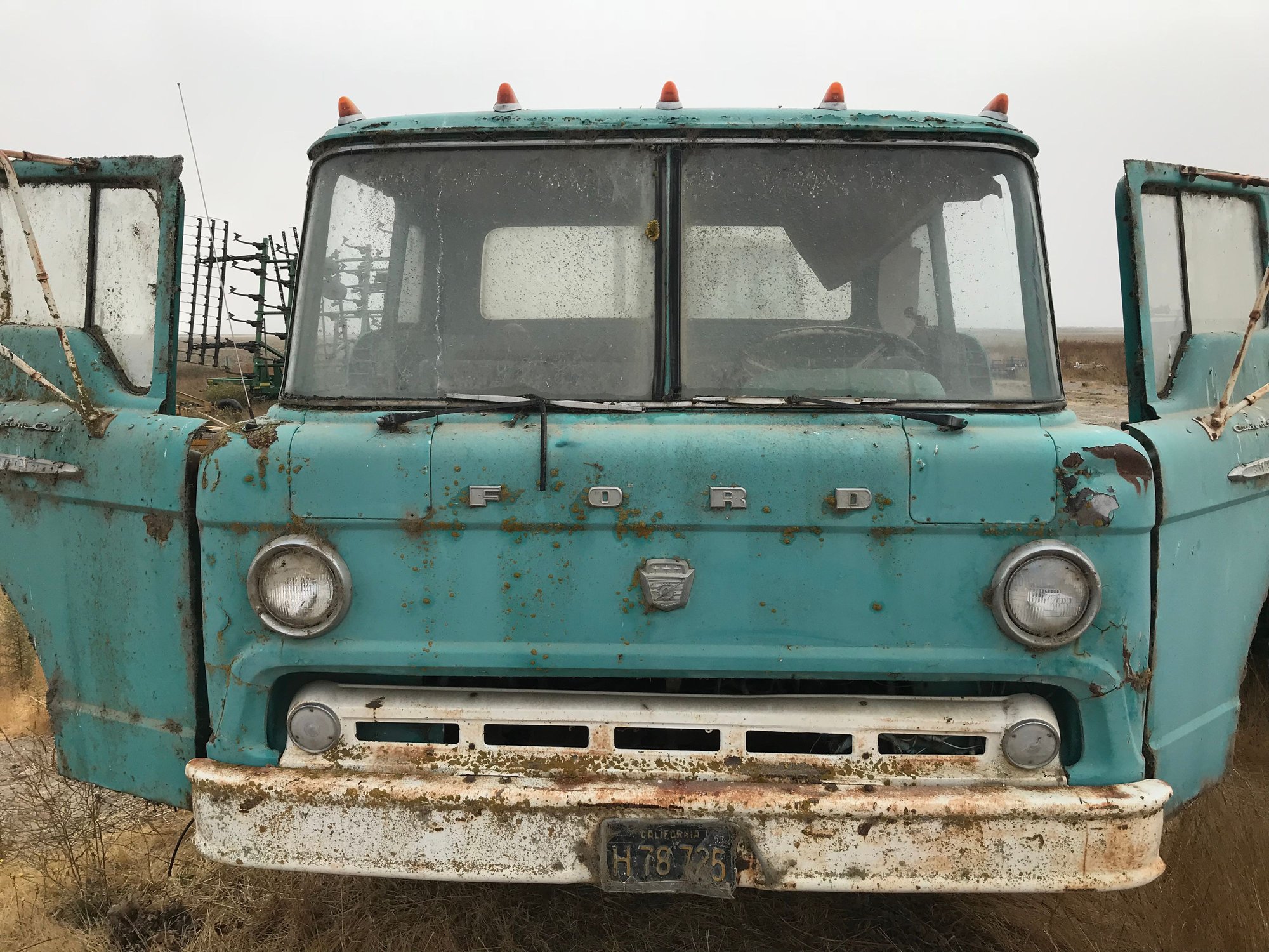

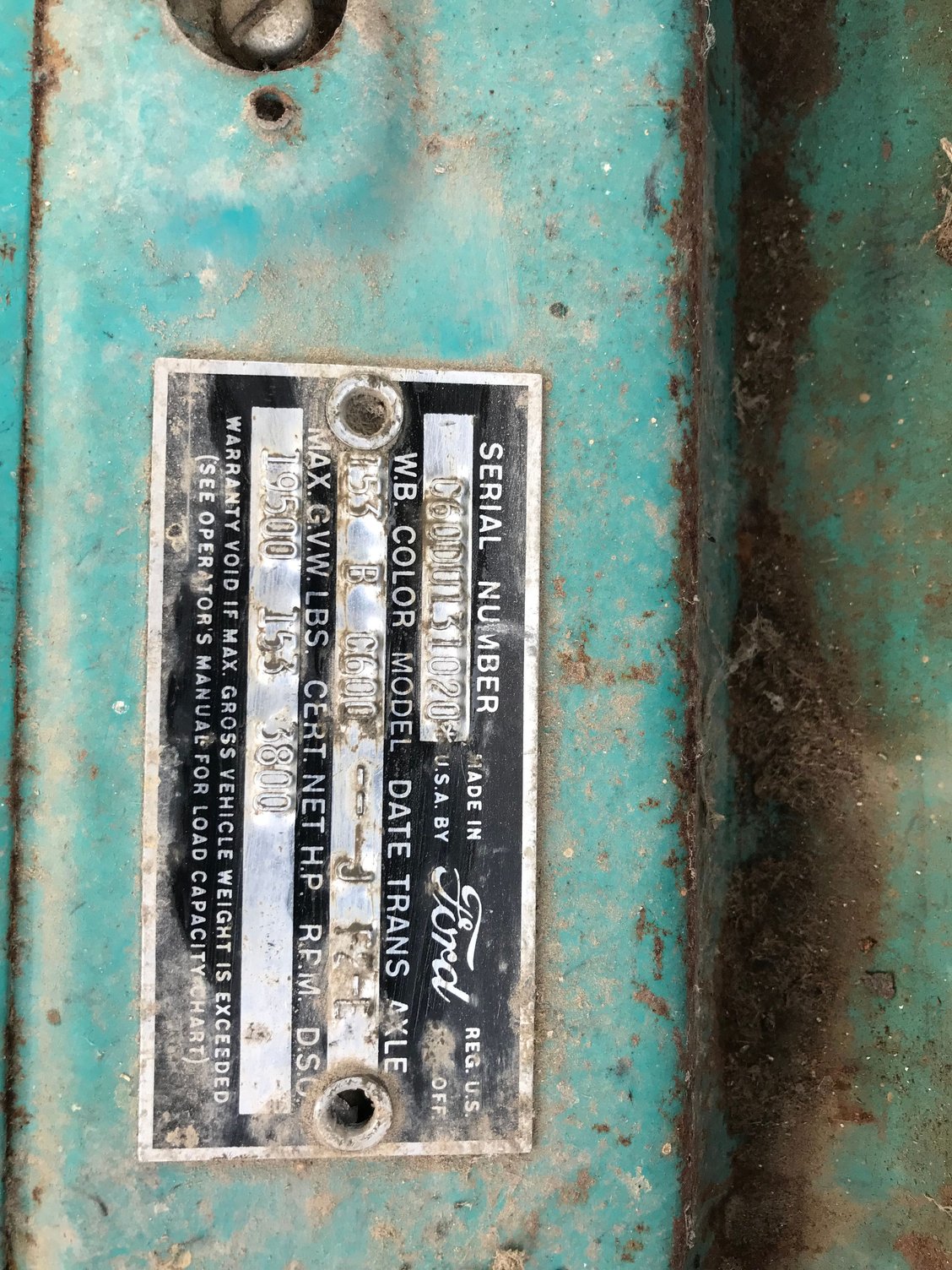

I normally am in the 57 to 60 F series pages but I stumbled on a 61 C600. Can't seem to ID the engine.
Vin is C60DU131020.
Can someone help ID this? I'll add a few pics from my phone once this is posted.

Here are some pictures.

I believe this is a '61 C600 manufactured in January 1961 at the Louisville, KY plant. Should be a 292 V8 with 4 bbl, 153 hp @3800 RPM.
I'm sure others more knowledgeable will chime in with transmission type and weight ratings, etc....

C60 - C600 (Gas)
D - 292 Heavy Duty 4V
U - Louisville, KY assembly plant
131020 - 1961 - Assembled January 1961
153" Wheelbase.
B - Caribbean Turquoise Color code
C600 - C600 (Gas) 19,500 Lbs GVWR
J - Clark 5-speed 250V Direct
F2 - Eaton 2 speed - 6.33/8.81:1 ratio 15M (15,000 lbs axle rating)
19,500 lbs. Gross Vehicle Weight Rating.
153 net HP @ 3,800 RPM

Wonder if a D code 292 (171 hp gross 153 hp net ) ever surfaced on this forum in a F100-F350 ( special order of course )
