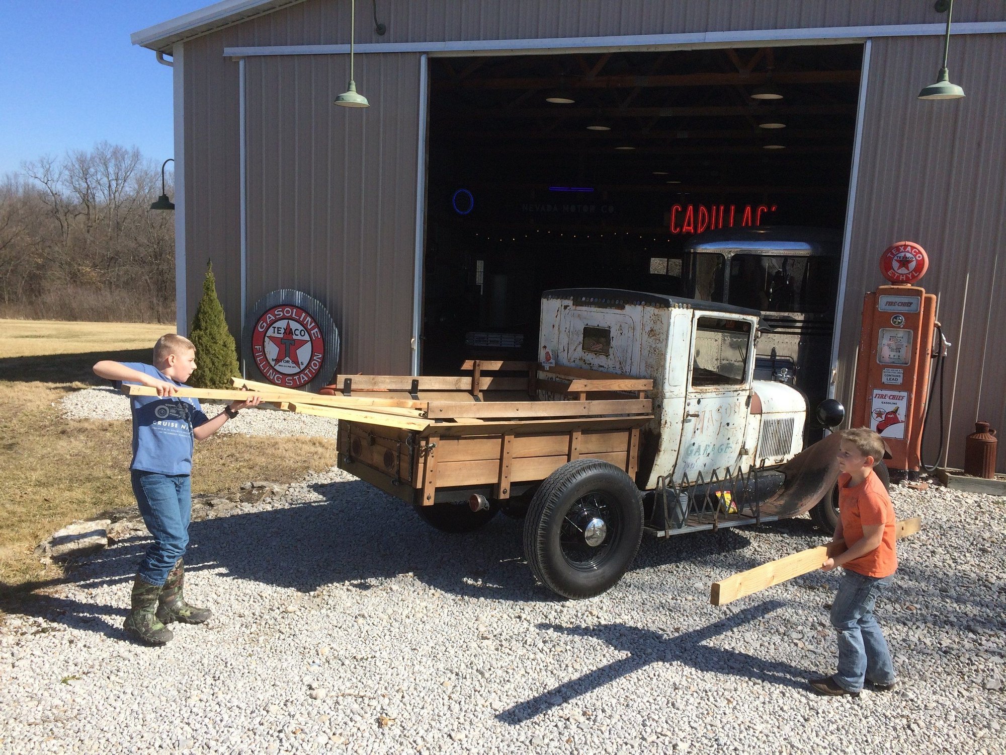

I had a very similar choice to make a years back. Love the T, especially a TT and the A's. I also had experience at a restoration shop doing both A and T work and found it a difficult decision for my own needs. Fortunately the market is down and there are a lot of good older restoration for sale, as well as parts/chassis from the hot rod market. I went with the A as it suited my city/country needs better. For the money you can get an "A" faster and stopping a lot easier than a "T" and the "A" following seems to have more to offer in the way of parts dealers and options (overdrive trans, brakes, performance upgrades). On your truck question: assuming the regular chassis (not AA) mid-28-31 chassis are about the same. Early '28 AR has some carryover parts and can be a little harder for the beginner. Most guys will favor using the later 30-31 steering box but its a simple swap into an earlier frame. You may also find fewer '28-9 closed cabs over '30-31 as the earlier bodies contained a lot of support wood. You may hear a lot discussion on the brakes, don't let this worry you, most people who complain never drove a properly restored mechanical system or used new cast drums. Whatever your choice, enjoy it! We managed 42k in 6 years on our restored chassis 1940's painted truck!

I love that truck Roadsidedesign!!
