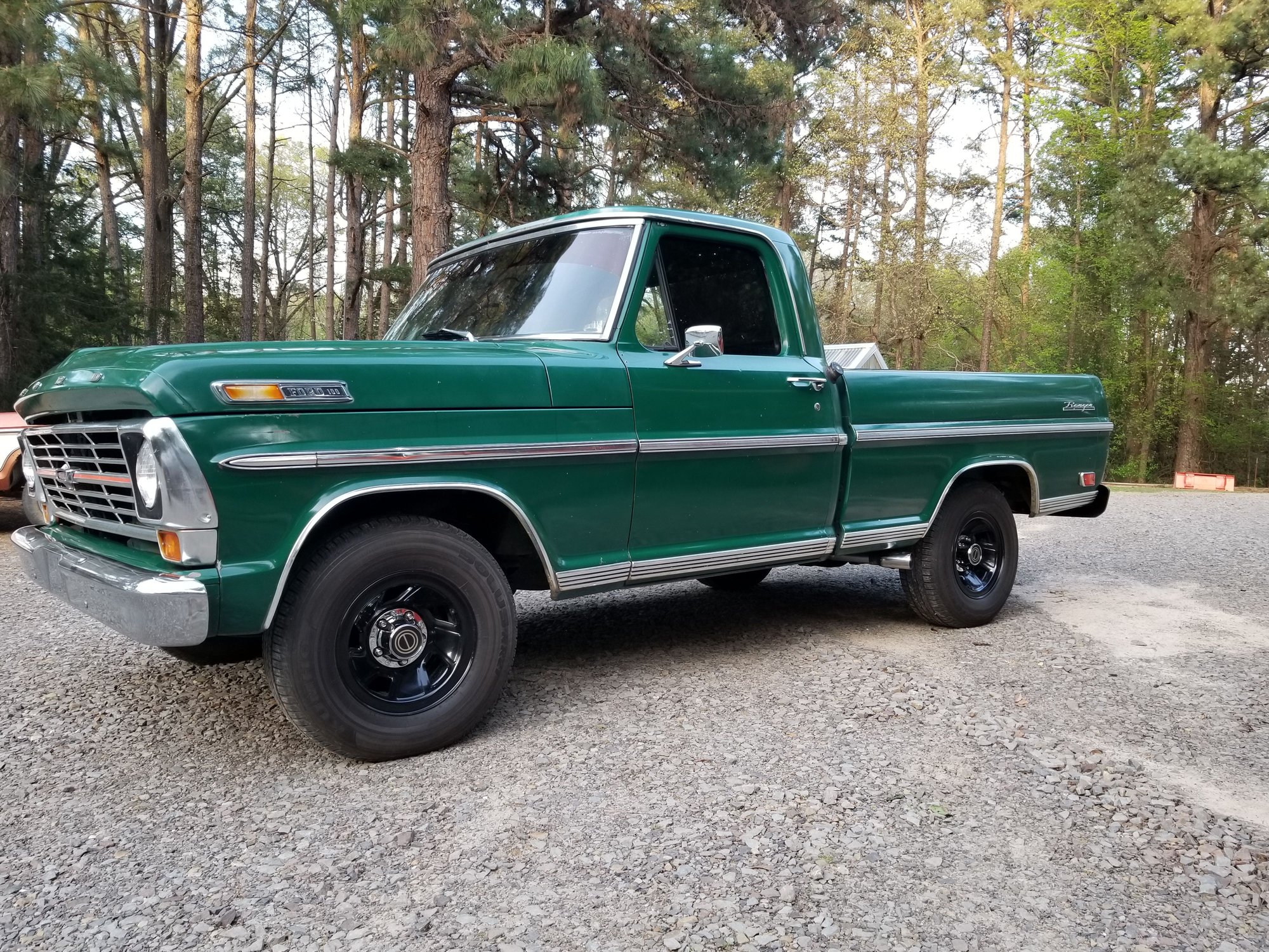

I drive my '69 F100 Ranger 5 days a week to work and back home (34 mile round trip a day). The only major issue I've had was the old tired and worn 240 gave up the ghost back in February and I replaced it with a 300 that I rebuilt.
If you get the mechanicals and electrical in good shape, these trucks are pretty reliable and are generally very simple to repair if something does go wrong.
