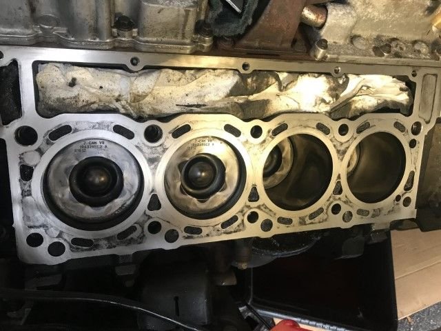

Heads removed. Cleaning to commence.

OK. I am going to need some guidance here. I used the CRC gasket cleaner on the block and all the blue gasket material is gone. Used rags and a plastic scraper. According the all I have read, that is all Ford says to do. However there has to be more. The plastic scraper and gasket cleaner will not take off the black and brown "stuff". The "stuff" is thick, I can catch my nail on it and even feel it if I run my fingers over it.
Not sure where to go from here. I do not want to do anything aggressive and ruin the block and heads. Honestly, I am a bit nervous to do anything more than a plastic scraper. Maybe I am just reading too much into the internet horror stories.
I do not have any machinist flat bars or anything like that. I have feeler gauges though. I do not have a stone or flat steel plate to "sand" the surfaces. What else can I do? I am pretty certain I can not just put it back together with the surface being so uneven that I can feel it with my fingers.

It depends how clean the gasket contacting areas are. The carbon and rust are in the whetted coolant regions, with the exception of the blow through. The scotchbrite pad Ford usually recommends is a 600 grit. You’re not going to. Do any harm with that and you can see in the passenger side start of my addressing the decks how clean that gets it. It was backed with something reasonably flat.
Brian, you know I don’t have problem with aggressive, as long as it’s flat. Where you are at right now, I’d get a stone, which can be as corse as 180 grit.

I went to HD and picked up the thickest piece of aluminum flat stock they had along with some green scotch brite pads. I cut down the aluminum to fit the pad.
This is where I am at. I am done for the day! On to the heads tomorrow unless someone sees something that needs attention? There is nothing I can feel on the block. Nothing catches on a razor blade or scraper.
