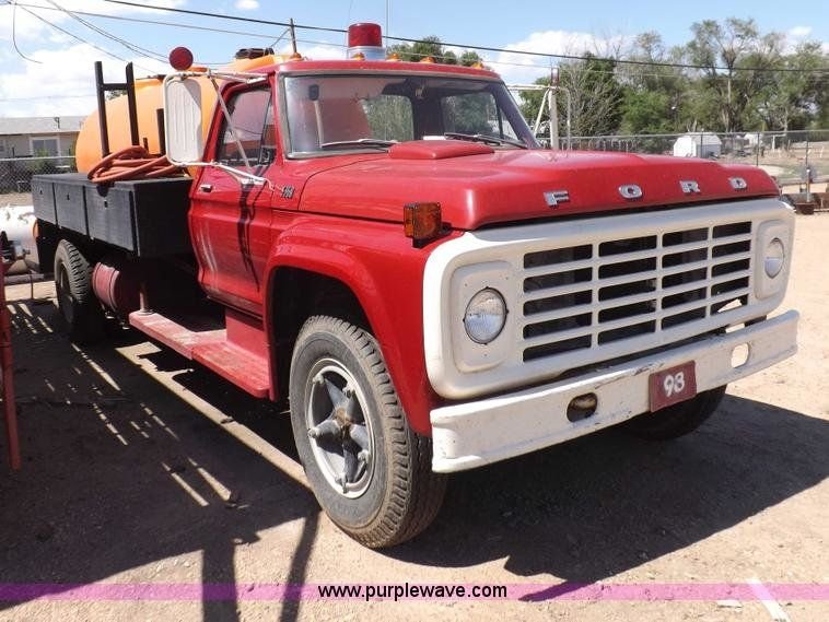

The outside door handles and push buttons are 1973/79 F500/880 only. The 1973/79 F100/350 & 1978/79 Bronco outside door handles/buttons are the same as 1973/78 LTD.
You will have to determine what has broken. The parts are obsolete, but are available NOS .. see pic...
Bill I'm not disagreeing with the Parts Book but I found this photo on your " If you need any info" thread post 927
74 model with lift handles.
I'm sure the doors could have been changed, the ones on the 75 model I drove may not have been originals, it was a used truck when I drove it in the mid 80's.
Just wondering if some of them could have came down the line with pickup doors on them.
D8BZ-5422404-A (replaced D3AZ-6522404-A) Right & D8BZ-5422405-A (replaced D3AZ-6522405-A) Left .. Outside Door Handles / Obsolete
1973/78 LTD/Grand Marquis; 1973/79 F100/350; 1978/79 Bronco; 1978/83 Fairmont/Zephyr; 1981 Granada; 1983/86 LTD/Marquis (Fox bodied mid-size).
D3TZ-5022404-A Right & D3TZ-5022405-A Left .. Outside Door Handles / Obsolete
1973/79 F500/880.
