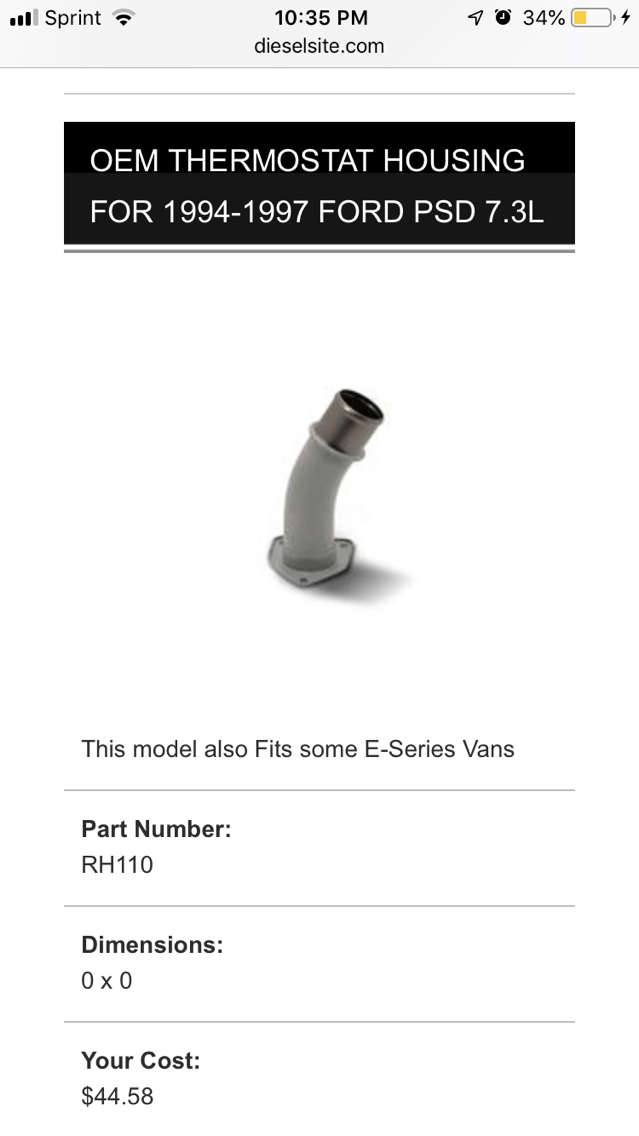

Is this the one

Originally Posted by '74 Ford 250 CS
Is this the one
Attachment 261972
Ah dangit, I had to fix this on another thread about the same thing. It's Strictly Diesel, not Dieselsite. Sorry about that. I'll find the link like I did for the other guy. When you see it, you'll get it completely.

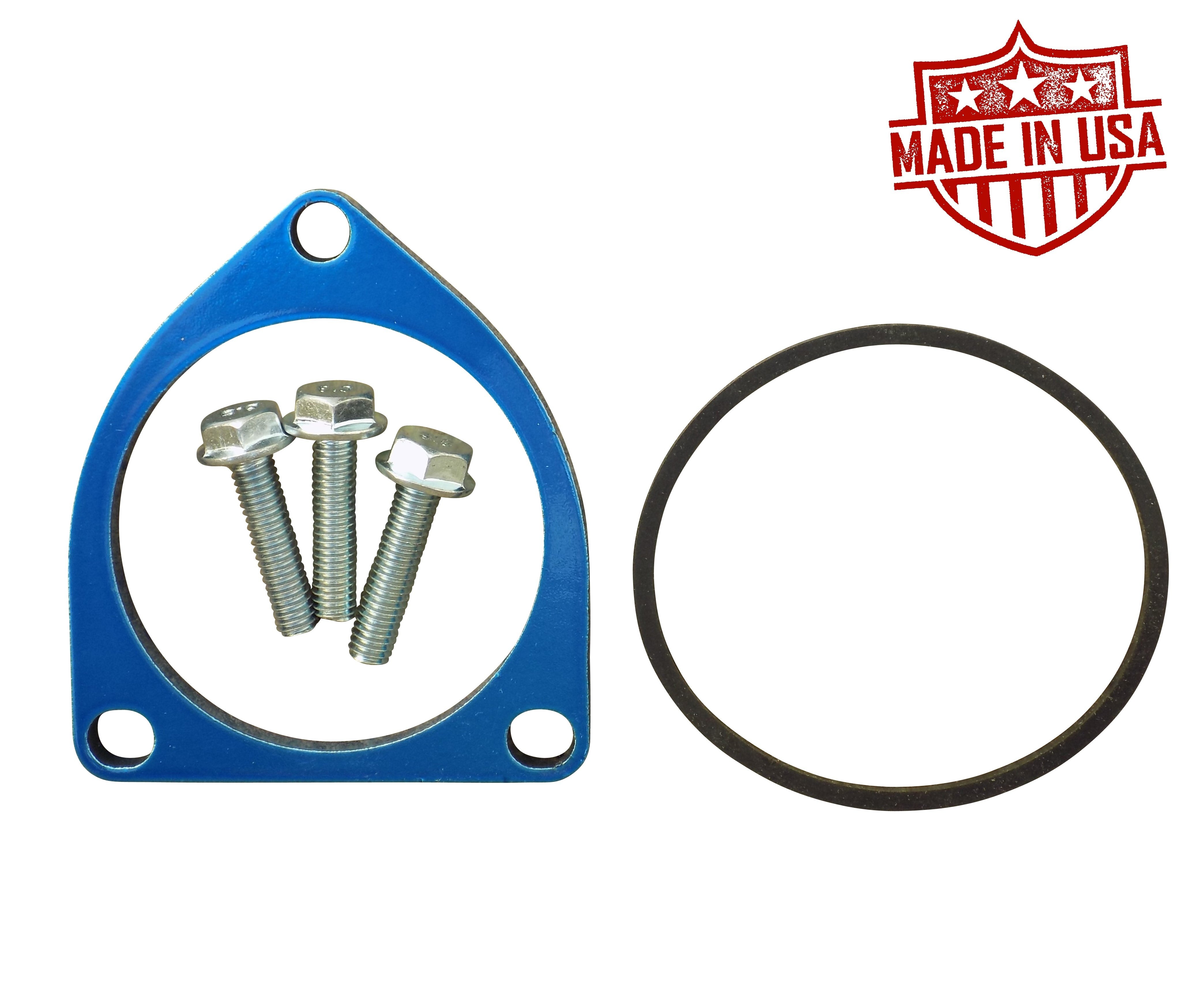

Here ya go.
https://www.strictlydiesel.com/p-267...sing-ring.aspx

https://kbdieselperformance.com/othe...esel-p89895029
Here's another link for the reinforcement ring. I don't know anything about the source, never done business with them.
