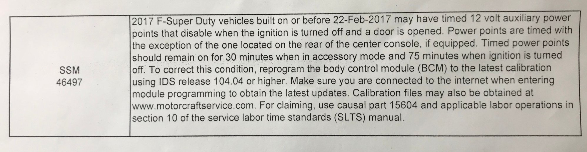

Here’s the fix:
Old Sep 13, 2018 | 10:13 AM

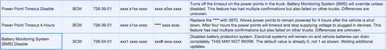

As others have said -
Using the FREE ForScan Software (windows laptop) and a wireless
ODBII adapter ODBII adapter
you can extend the length of time the power outlet remain powered on.
Using a laptop or tablet with the ForScan Software installed on it you would make the following (simple / diy) changes listed on the ForScan spreadsheet.

^^^Yep. BUT - If you have an early build 2017, you have to have the dealer reflash the BCM first per the above procedure (post 8). After they do that, the FORSCAN fix should work. For all others manufactured after Feb 17, just the FORSCAN is needed.

Thanks very much for all your help, I have an early build 2017 King Ranch so it's off to the dealership to do the upgrade. Thanks again everyone for all your help I know what's needed now.

OK, Here's the latest. My 2017 F350 King Ranch (drw) is an early build and the BCM has to be reflashed to the latest update before the FOREscan will work. So nuctrooper is correct. I have an appointment on the 20th of Sept to get that done. I'll let you know how it turns out.
